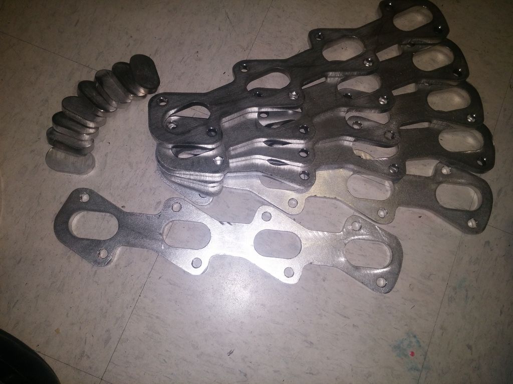

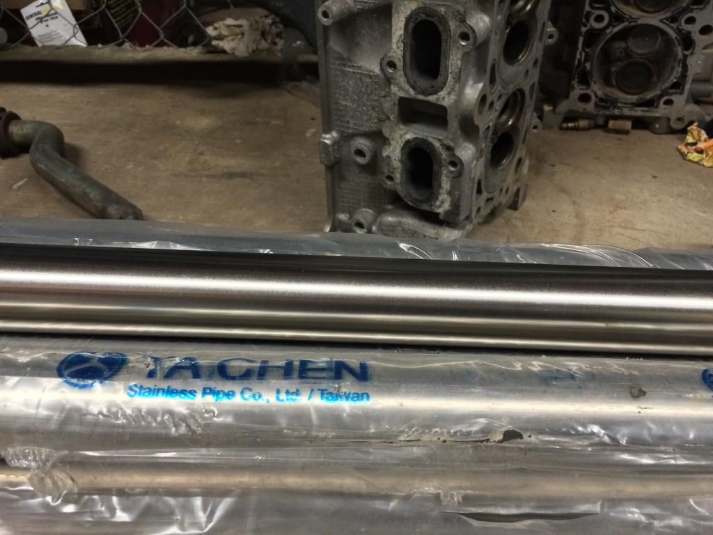

You have to be careful with stainless steel headers. They normally require backside protection against the atmosphere during welding because they oxidize severely in the presence of oxygen.
I should have a nice little treat for MN12ers very soon......
.....and they will come in many flavors.

that's actually exactly how they got cut! layzer powah!!

Possibly. The only way to know for sure is going to be to buy them and mock them up and see what is hitting.
Roger that.
CNC bender for consistency? Or?...
