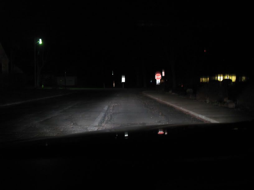

Posts: 3,391
Send a message via AIM to Tx_Cat Send a message via MSN to Tx_Cat Send a message via Yahoo to Tx_Cat
Could you take a picture on the street to see the complete lighting?
PhotobucketNitrous and boost go together like peanut butter and jellyPhotobucket
Nuttin make you feel more like a man in a Thunder Cougar Falcon Bird
Tx_Cat is offline
post #41 of 427 (permalink) Old 10-30-2009, 08:19 PM
theterminator93's Avatar
Join Date: Jan 2009
Location: Avon Lake, Ohio
Age: 29
Posts: 8,637
I'll do that in the school's parking lot before I pull in my driveway when I go home. Note however that these are not aligned - I've got them pointed down as far as I can get them so I don't blind anybody.... so things will look better probably after tomorrow or Sunday evening.

No, no... it's fine. I have to remove them again anyway so I can silicone the rear to create a moisture barrier. I've just been working a lot lately and don't have a lot of time during the day to do much.
Here are pics of the 'rough' alignment I did in 5 minutes without measuring anything. The driver's side headlight was too high when I took the pic on the street and it was lighting up the woods behind my house (about 300 feet from my car) so I have since dropped it a bit.
Compare that to this, which I took after I installed my fog lights. Although the camera was on different exposure settings for the two pics, you can still tell there's a good difference. Fog lights were not on for the HID pics.

Oops... slight mistake - I mean LEFT to RIGHT.

Very impressive. Better than silvestar bulbs.. lol Nice job man. What type of silicon are you going to use to seal the housings?

What temp did you get? 6k?

Ok... I am 100% impressed with this thread.
Thanks for all the great pictures and fantastic write up on how you did it.
Definitely ordering some this week. When you ordered your kit, did you order the 9007 kit? And what bulbs came with the projectors? was it the D2S ones?
EDIT: Can we get this STICKIED?!?!?

I do intend to get some good pictures of where I mounted the control gear, how I routed wires, where I grounded etc. when I get the chance; might not be for a day or two.
I picked the 6000K bulbs, and they look like the D2S bulbs that come up in a google image search (although I'm not very HID-literate so I'm not positive that's what they are). I'm not exactly sure which silicone I'm going to use at the back; I'll probably just RTV things into place. My goal was to accomplish a completely reversible retrofit, so I want to be sure I can undo this if I ever have to.
