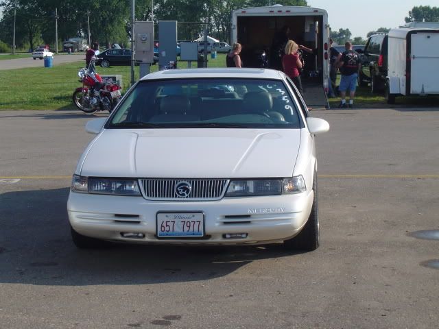

post #129 of 427 (permalink) Old 11-21-2009, 07:44 PM
Slightly Disjointed
Posts: 15,407
95-97 grand marquis headlights, they bolt right on, they just need some header panel clearancing and wiring for the high/low bulbs.
I'd bet the projectors would fit better in these than the 96/7 housings...
hmm... maybe dual projectors

the dual projectors was what i was thinking of with the GM lights but i need to buy some new lights first because mine are shot lol.
Matt, I am always jealous when i see your cougar, at that angle it almost looks like a marauder.
