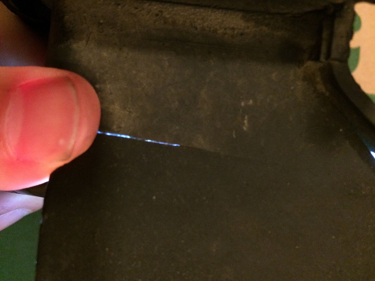

Make sure you check the right side of it, just behind the two bolts that cross through the diff cover where it starts to bend to go into the rubber isolators. That's where mine split.

If you mean the entire thing, I have no clue lol. If you mean the part where the cover bolts to, that's actually copper RTV.

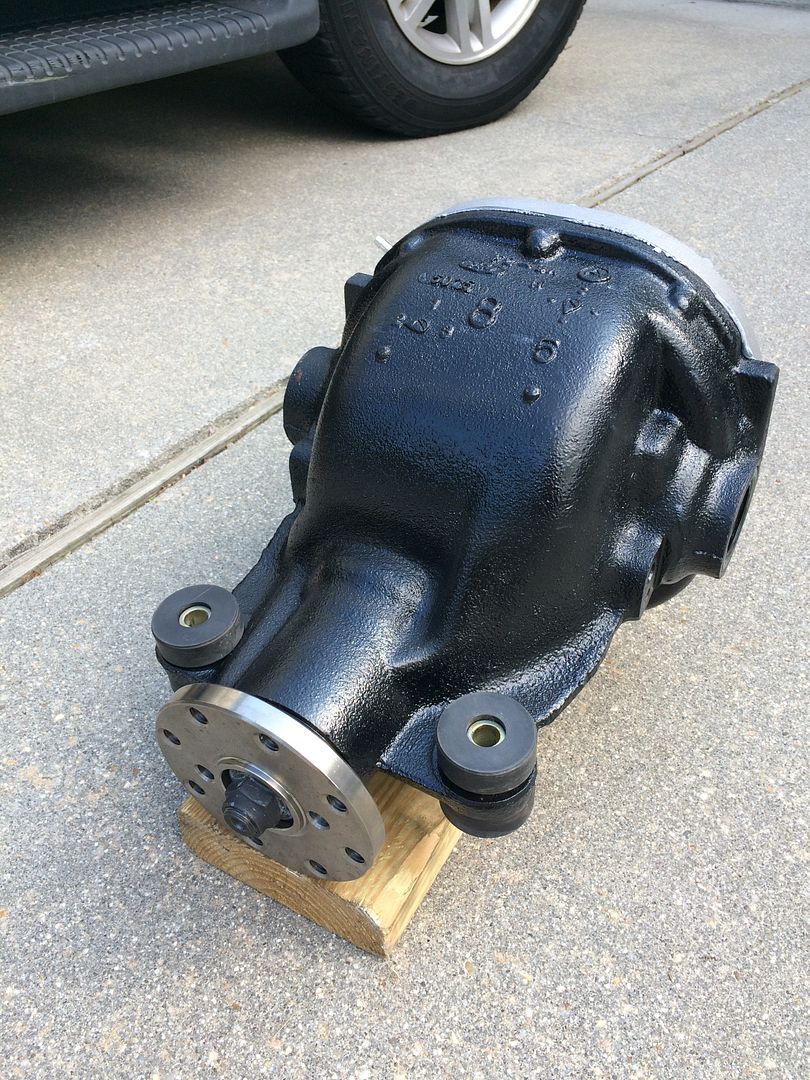

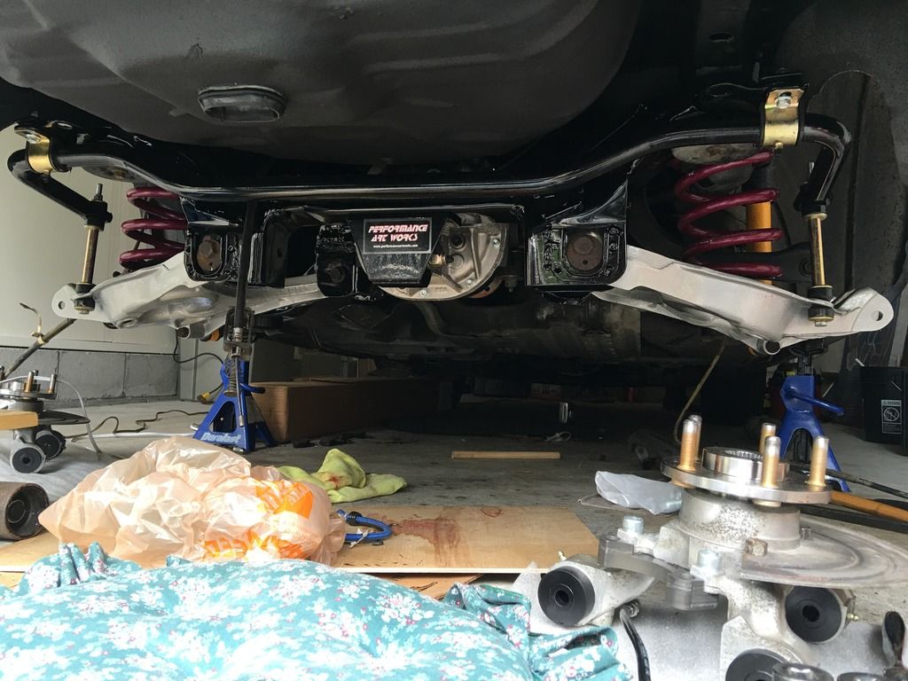

New progress. My differential is permanently done for the life of the car, needs no more mods and will only be dropped for maintenance if necessary, but now I actually have drain plugs yay!

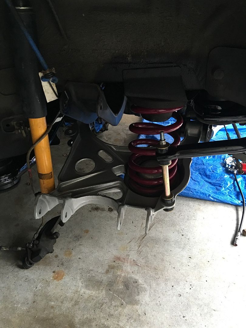

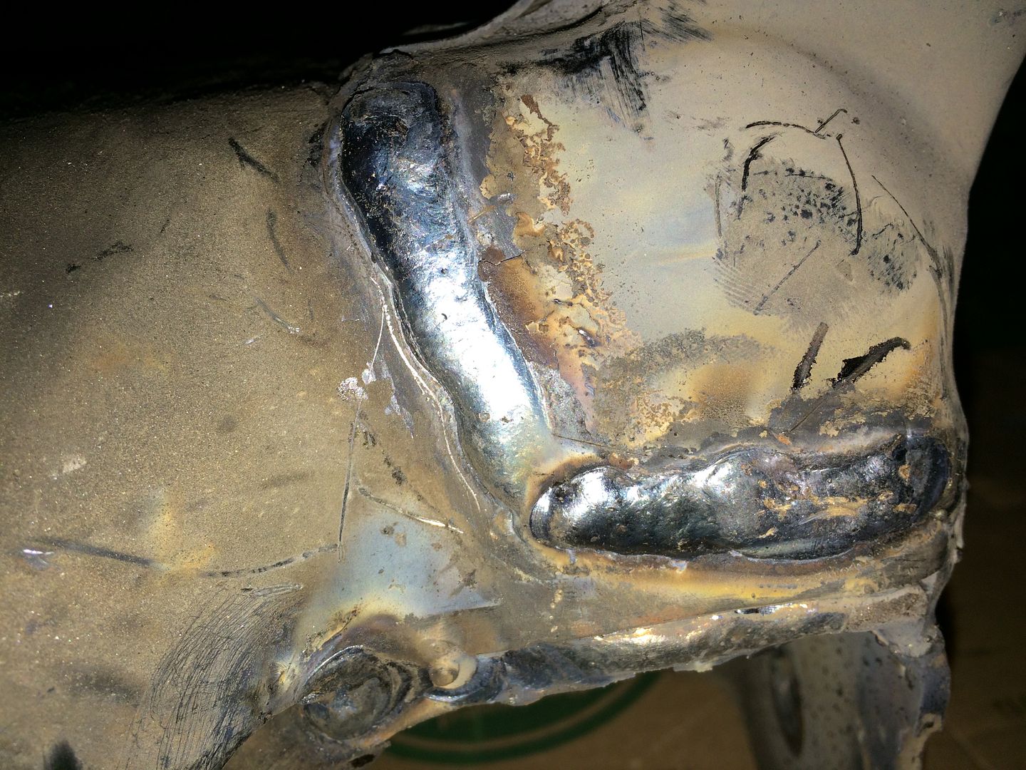

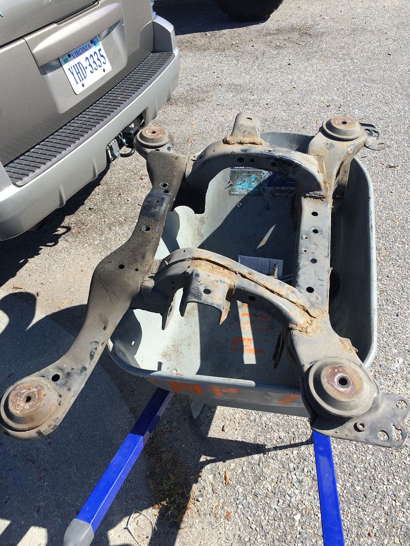

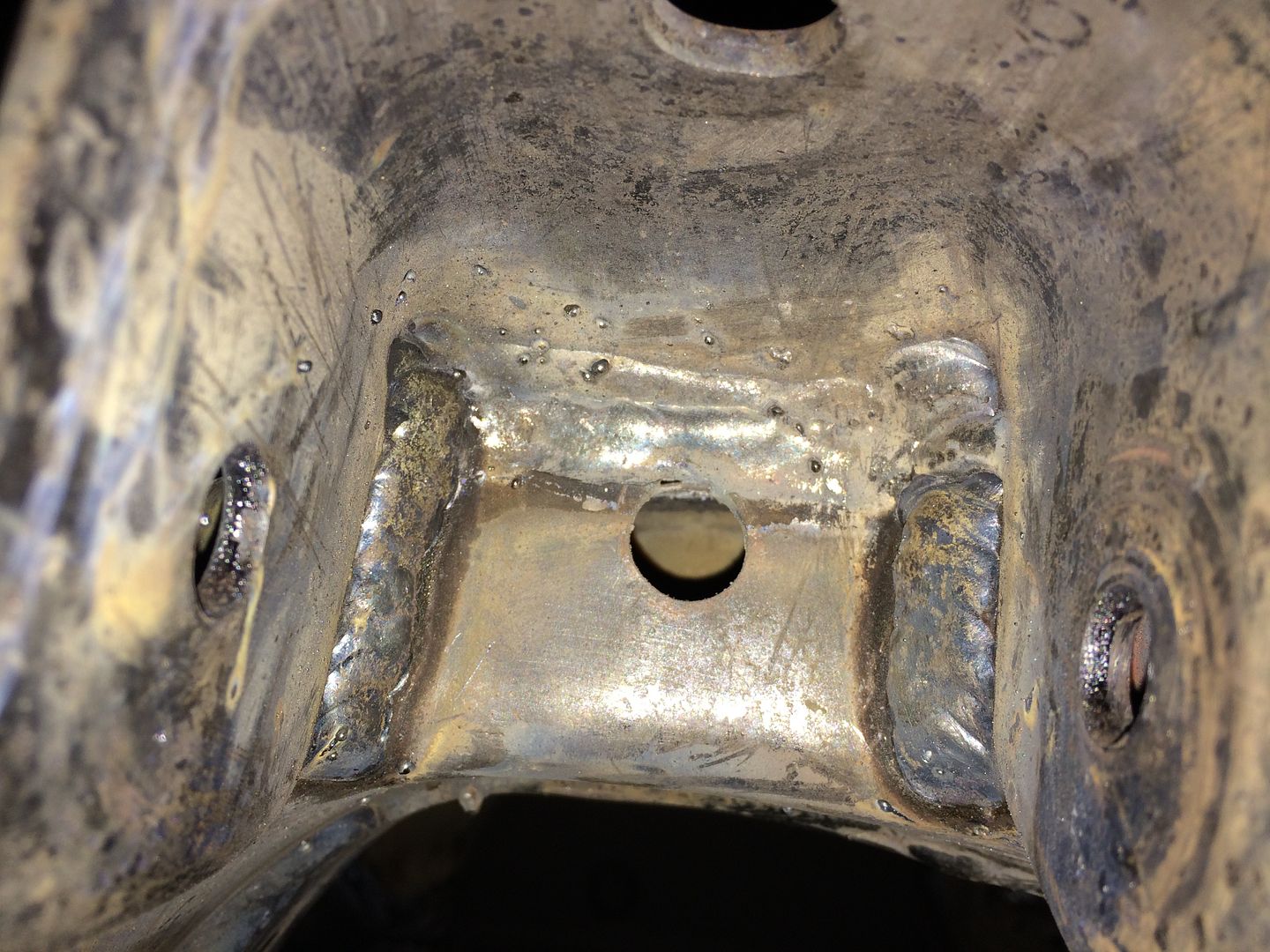

The new-old sub frame I pulled from a V6 tbird.

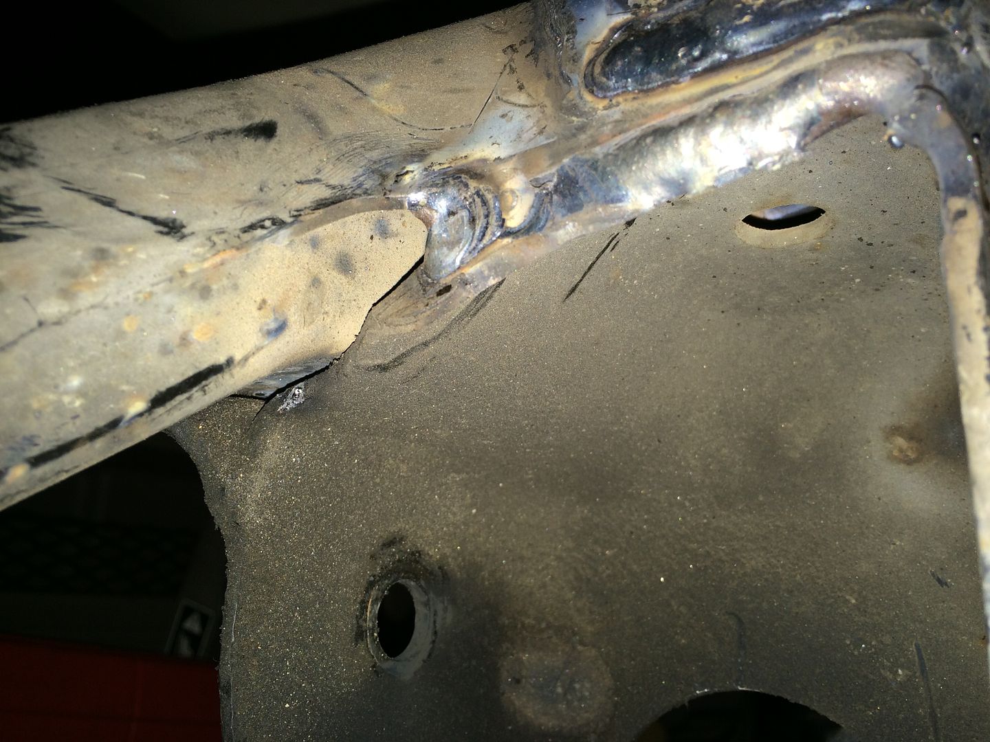

71,000 lb flux core ship welds for you CWI's to inspect. Done by a former ship welder/welding instructor. He said these welds will out-live us both. Ron any thoughts? He added 10 lbs of weight to it in wire alone during the welding process.
Ron and this guy could literally have talked for days about weld roots, puddles, tensile strength, tearing, donkeydicks (welding term), and who knows what else. This guy knew his stuff, and he even offered to teach me how to weld if I buy a welder, GM why don't you send your welder my way so I can show you how to use it when I learn

post #18 of 41 (permalink) Old 10-21-2015, 08:25 AM
Location: This week: Rochester, NY
Posts: 10,875
Welds look good for the most part.
There's a goober (welding term) at the tie-in in the first weld picture that should be ground out and blended.
There's weld splatter (spatter) in the next to last photo. This is really a non-issue.
There's cold roll (lack of fusion) at the lower right side of the weld in the last picture.
It doesn't look like he did any surface prep work. The accessible welding locations should have been ground clean down to bare metal with a wire wheel prior to welding.
After welding they should be wire wheel or wire brush cleaned again for inspection.
First photo - Grade B - Poor tie-in
Second photo - Grade C
Third photo - Grade C - Again - poor tie-in at the corner
Fourth photo - Grade A - Good weld in a tight location
Fifth photo - Grade C - Cold roll
Overall Grade C
Trunk Monkey - AWS CWI
If we have any welding done here I'll show you what our welders are capable of. They never cease to amaze me how good our welders are.

The welds look alright IMO..You know, the whole point of welding up the subframe is to provide substantial strength to the stamped frame..
I'm just curious why you didn't box any of it in with tubing?
This TCCoA article is great at pointing out what needs welded-->> IRS Build-up How-To
You should consider picking up some of the Delrin control arm/knuckle bushings from Jay aka 98mark8lsc..If you're really interested in getting rid of any potential wheel-hop that is..
That and also either aluminum or Delrin rear subframe bushings..
Keep us posted on your progress..This has the potential to be a very good thread..
Im wondering why anybody thinks the subframe NEEDS additional welding. Any engineers care to chime in ???

Spoke to my welder prior to letting him loose. He said the boxing of the control arm boxes is extremely overkill. He said there is more than enough structural strength, especially after he welded the areas he did to reinforce it. I plan on getting UHMW mounts from Jay with Delrin bushings and the custom DSS $1700 axles. My rear half of the car will be bullet proof.

FYI, you can buy the chromoly outer joints for about $500. 99% of the time, that is what breaks, so you could likely save yourself $1000 and still have a pretty bulletproof rear. Not sure what your ultimate plans are, but considering how much power stock axles have held up to after the delrin bushing upgrade, I think that should be sufficient, and it is what I am going with behind by 427" Windsor.

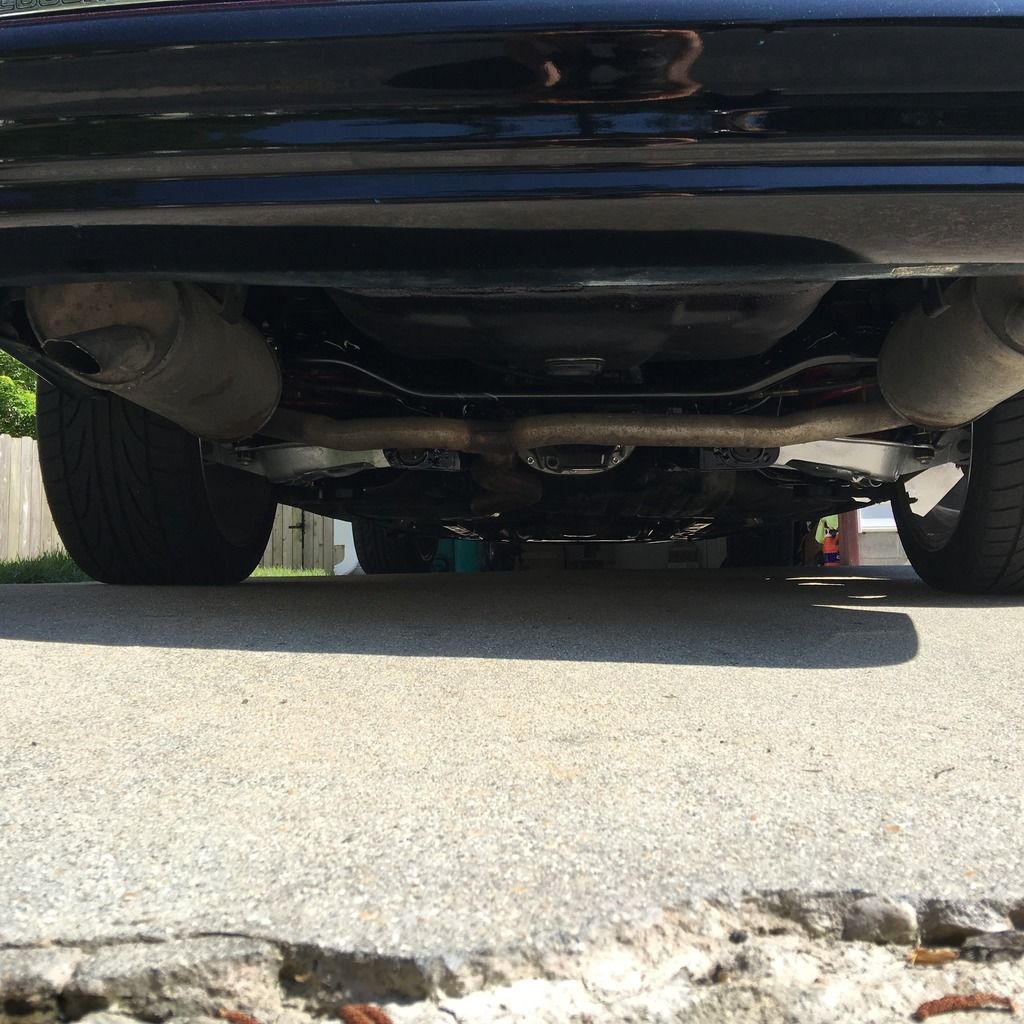

A large update. Axles came in, and Delrin bushings arrived. The beast is back on the road, it needs some minor adjustments, but the car is super stiff and tracks straight as an arrow.
1,500 HP axles (DSS Pro-levels)
MN-12 Arms with Delrin Bushings
Pro Level Custom Hubs with ARP wheel studs and Cobra Caliper brackets.
Shiny new progress.
Fresh 3M undercoating and putting the puzzle together (New Driveshaft was in that long box)
Trimmed the wheel studs to fit my cobra wheels. (Thanks Mike!)
Money shot! (No, seriously...so much $$$ in the ass of this car.)
On the last step, adding fluid.
After a quick test drive, all was well, threw the exhaust back on.
