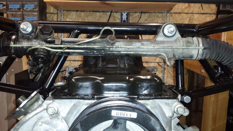

Just a little update. The stock Coyote oil pan will not fit on the stock k member or the AJE k member. I thought a low profile coyote oil pan was going to work but it will not fit either. I have to make a custom oil pan and that is out of my skill level since I have zero welding experience. I called Moroso and Canton for a bid and Moroso won by $300. The pan's sump should hold over 7 quarts plus the oil filter 8 quarts for the system. The part that sucks, the oil pan will take 6 weeks to build and get plated.
Second with the exhaust, I was planing on cutting off the Kooks flange and having the coyote flange welded on in it's place. I find it too risky for screwing up a perfect pair of headers so I'm going to see if I can have the kooks flange welded on top of the coyote flange. Not sure how the clearance will work out until I have the engine in the car.
BTW if you buy a 2011-12 coyote engine you will need coarse threaded exhaust studs and nuts to bolt your headers. 2013 and newer are fine threads. Just found that out today.

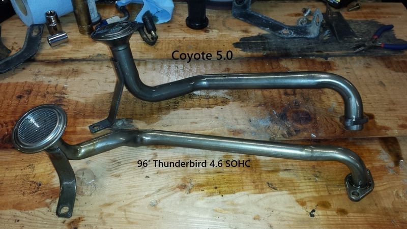

Will that oil pan you are having them make clear a stock K-member as well, or just the AJE? If it will clear a stock K, then that will make Coyote swaps easier for people in the future, and Moroso should assign it a part number.

I don't think it will. I made all the measurements from the AJE k member. Maybe modifying the stock k member to work with a Moroso or Canton Coyote Mustang oil pan would work? The Thunderbird oil pan bolt holes line up perfectly except for the front four on the bottom of the timing cover. Someone with welding and metal work skills could make it work with a Mark VIII oil pan with the extra side sump. The Mark VIII oil pan holds 7 quarts I think?

6qts for the MarkVIII pan. Does the shape of the pan in front fit the same? If the only issue is bolt hole misalignment, then that is an easy fix!

Posts: 7,363
Yea it fits, lots of room. Below is a Thunderbird oil pan. If you can make a Mark VIII oil pan work you the only problem is the pick up tube. You have to leave enough room for the pick up to dip down and back. It needs to be extended two inches and the filler part down a inch. The Thunderbird / Mark pick up will not work since it's a smaller diameter and will not bolt up correct on the oil pump.
