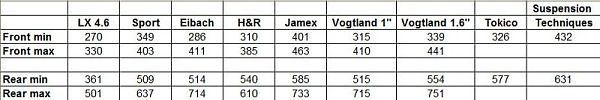

Found it!
See the spring rates in the technical articles at this link:
http://www.tccoa.com/articles/mn12-t...gs/springs.htm
I also found this information on spring rates over at SCCOA. In this thread. Post #8.
Also see this thread here:
http://forums.tccoa.com/44-suspension/127050-eibach-vs-vogtland-need-opinions.html#post1280536

Last edited by Trunk Monkey; 02-20-2013 at 06:54 PM. Reason: Add spring chart photo

Added picture.
I remember back when a lot of the old timers were running V6 springs on the front for the weight transfer at the track.
The springs I pulled off mine are tagged FOSC-5310-CA and the color of the tag is yellow.
I used a picture that Swanny posted of his springs and the tag color looks white.
There's a thread somewhere I'll have to dig up that someone posted the tag numbers on their V8 springs.

The Unsprung height of the stock (non-sport) rear spring is 13 3/4"
The Unsprung height of the 1.6" drop Vogtland rear spring is 11 1/4"
A difference of 2 1/2"
The diameter of the stock (non-sport) rear coil is .670"
The diameter of the Vogtland rear coil is .720"
A difference of .050" or just under 1/16" heavier.
