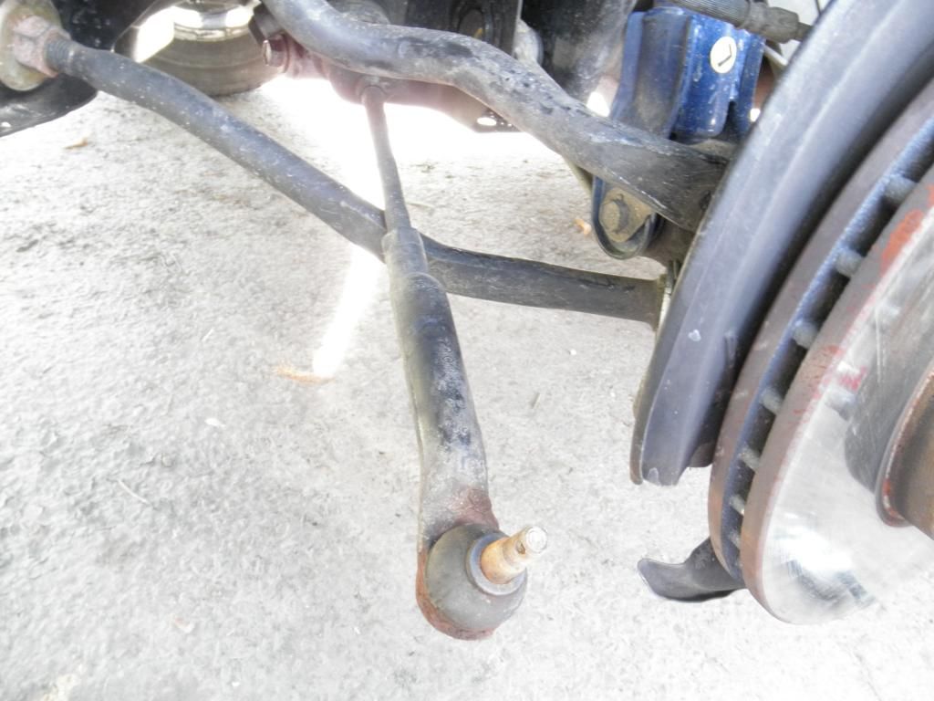

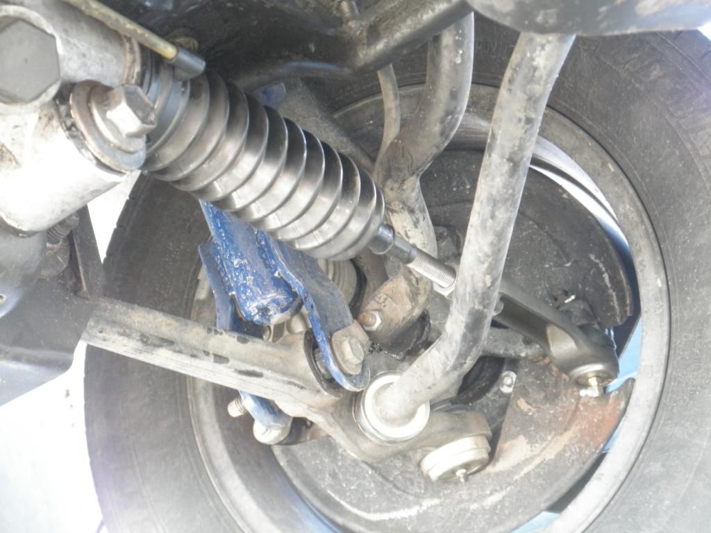

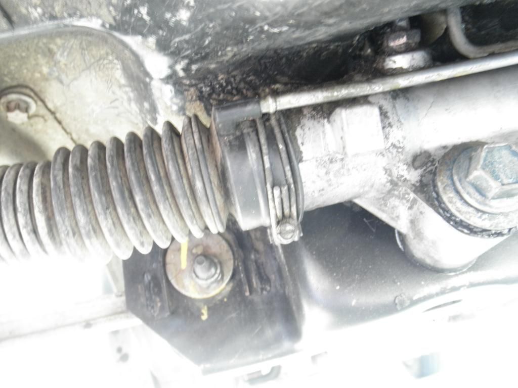

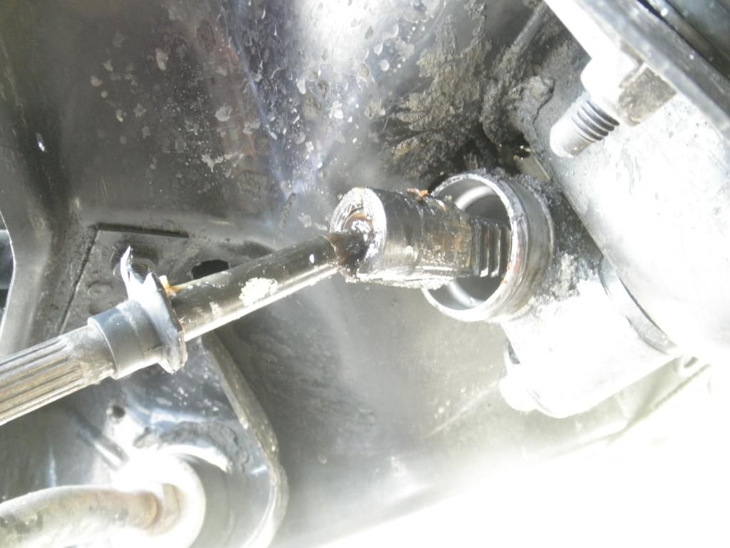

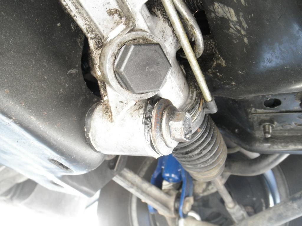

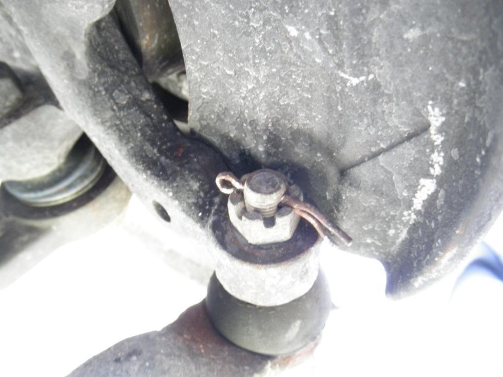

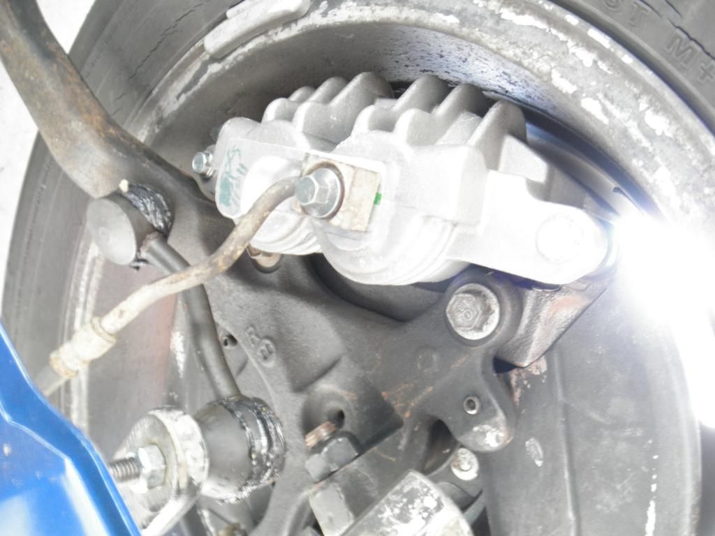

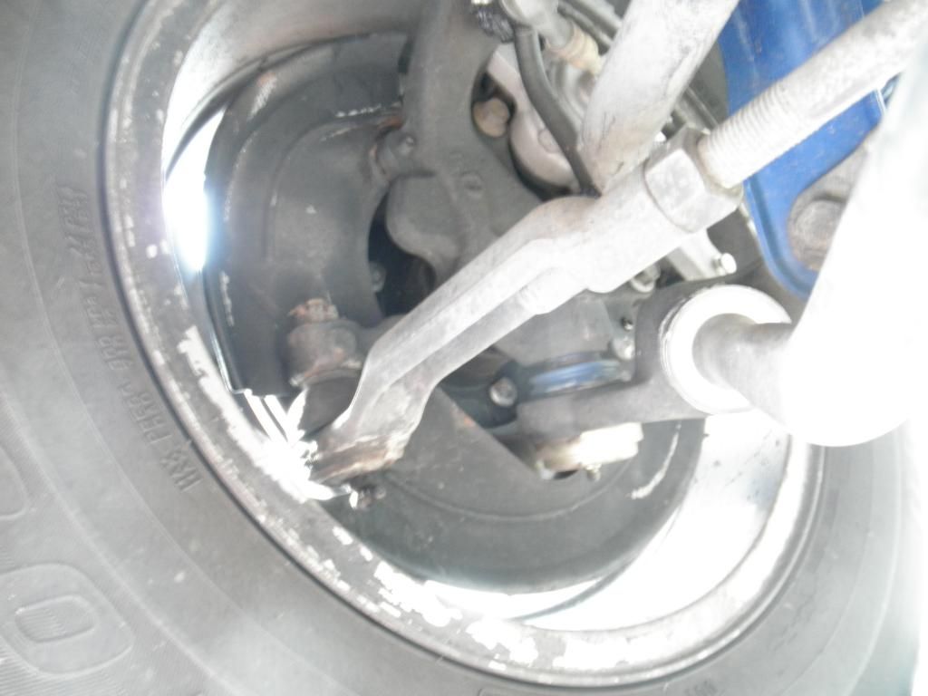

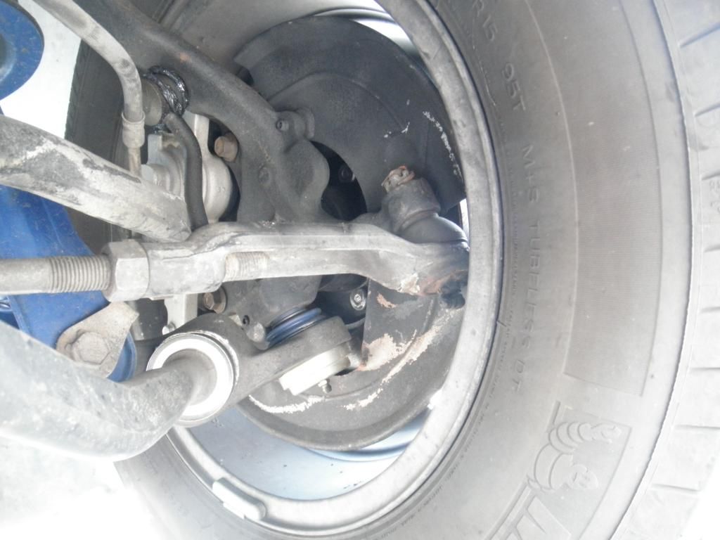

Here are some pics of my car, I want to fix up the suspension. What parts should I order.

See the boots gone on the sway bar end links, and the LBJ (Lower Ball Joint), so likely the UCA is the same.
I am going to say...every suspension and steering component with a bushing, ball joint, or boot. On the front, UCA (Upper Control Arms), LCA (Lower Control Arms), strut rod bushing, swaybar end links, swaybar bushings.
Can't really see the outer tie rod ends, I have never really dealt with bad inner ones.
In the rear at least the swaybar end links.
My 89 was nearly as...grungy and a couple of pressure washes later I no longer get so greasy doing simple things, and i think I fixed the oil leak (cork gaslets on the ends under the lower intake) and it really hate working on greasy cars any more.

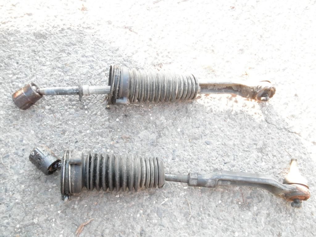

I need some advice on replacing some tie rods(inner and outer). Is it a difficult job to do? And what brand should I get?
I think my worn out tie rods is causing my new rack and pinion bushings to wear out. I just want to make sure I get the job done right and get the right parts so I can have better handing.

I replaced the tie rods, it wasn't very difficult at all. Now the car steers alot better now.
