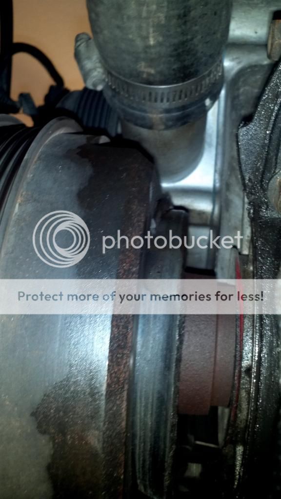

Well..You won't be able to tell if it's bad by looking at it from just opening up the hood..
If the rubber is separating in the Balancer..You're going to have to get on your back, and crawl under the car..
You'll have to lift the front end so you can get a good look at it..
Take a good look between the Oil Pan and Harmonic Balancer..If you see any rubber protruding from the Balancer you'll have to replace the Balancer..
Like this:

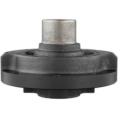

Compare that to a new Balancer:
It wouldn't hurt to use an inspection mirror to have a look at the backside of the Balancer as well...Just to see if there's any missing rubber in it..
