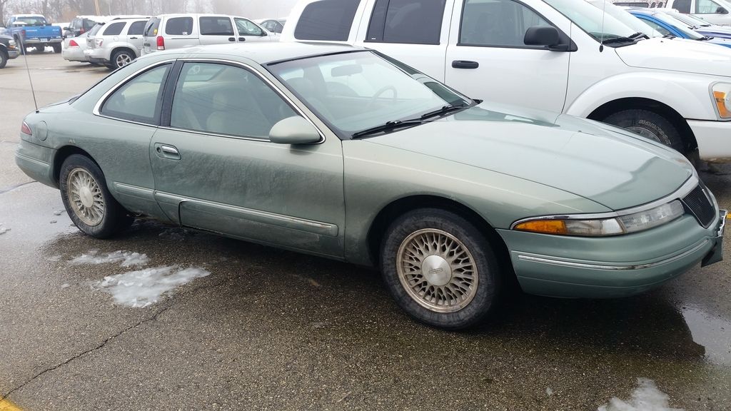

Well got a call from a former roommate about him wanting to get rid of his 1994 mark vIII. $400 later the car came home. has 151000 miles and lots of cancer. Seems to have a random front air bag leak. Cruise Control doesn't work either. Plan is to drive it through the winter when weather allows and then start parting it out for the tbird and anybody else that wants to buy some parts come warmer weather. Car is dirty but you get the idea.
