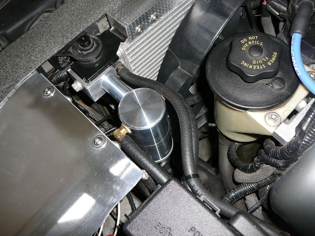

Here's a DIY pic from an F150 engine bay. The heatsinks are entirely unnecessary

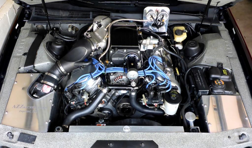

Racecougar: That separator is nice but that engine bay made me jealous!
