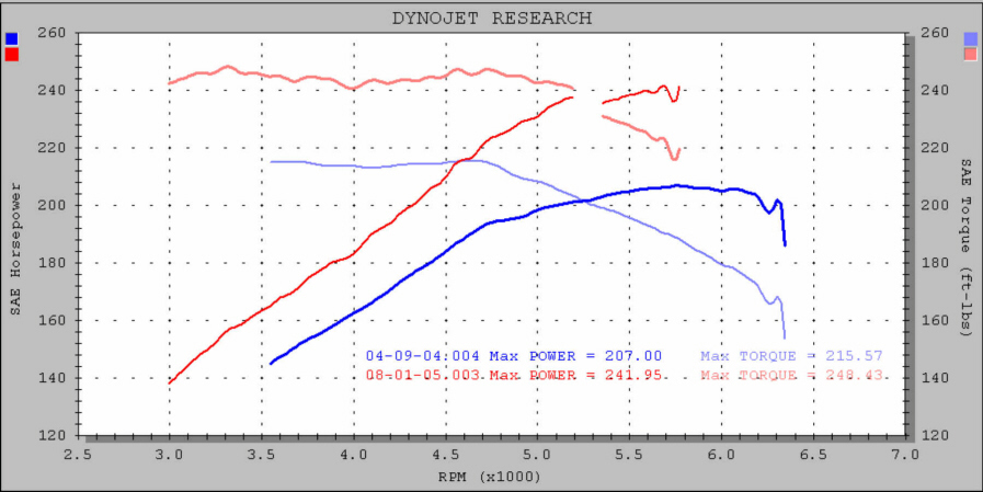

Not on topic, but just to clarify what a basically bone stock 32V (97 Mark VIII LSC) will put down at the wheels (blue line is the Mark VIII, the red line is my 73 Vert(351C-4V)):
Most likely these numbers are on the low side a little because soon after that dyno, I threw a "sticking IMRC" code and had a coil start misfiring. But nowhere near 250!!
But the point is moot as the OP specifically said he wasn’t interested in a 32V swap.
IMHO, it really boils down to a cost/benefit analysis while also factoring in intended application and uniqueness. I’ve never been a fan of “xxx hp” as it is only a number. What is important is the overall package, not just some peak number.
But just my .02.

Yep-that's about what I've seen out of them...215 ft-lbs. And I get scoffed at when I describe the B-head 4V as the "torqueless wonder".
