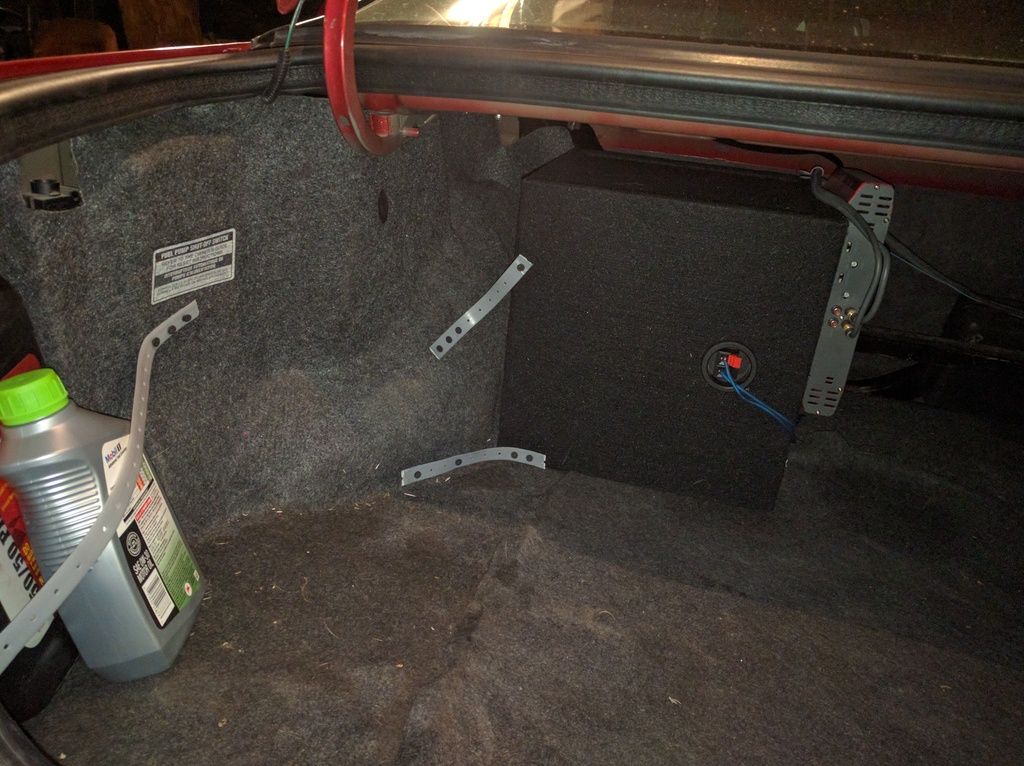

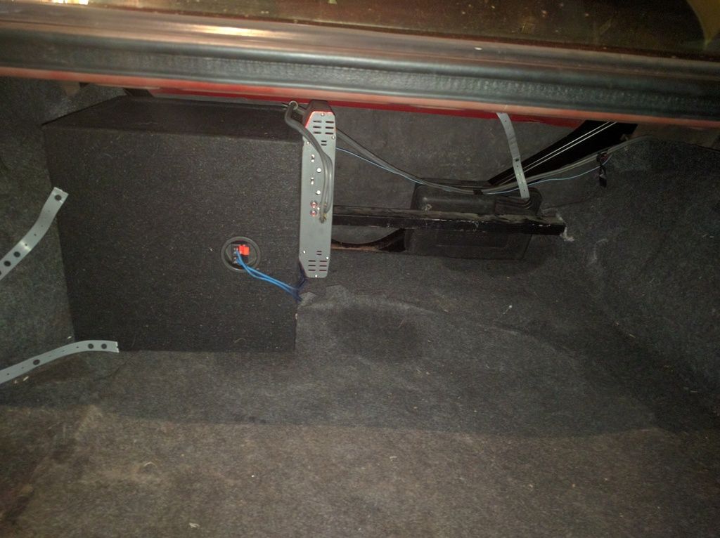

Can't see the sub itself, but this is the box and the amp, which I attached directly to the box to save space and make the wiring a little simpler. There's also a portable air compressor that Traveler was kind enough to leave in the car tucked in behind the shock brace.

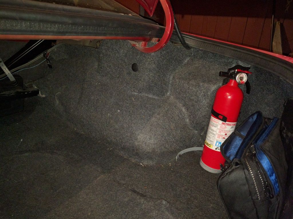

On the passenger side I have my emergency kit (first aid, flashlight, etc) and a fire extinguisher.

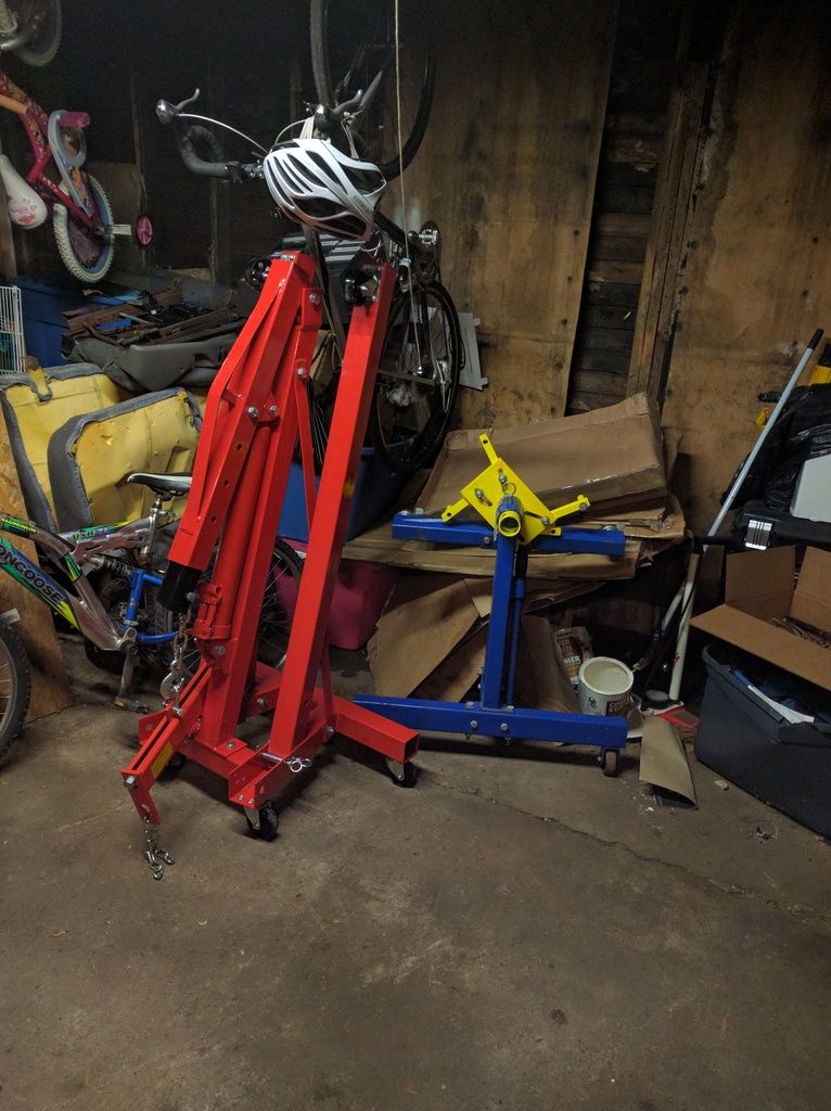

And here is my brand new, just put together last night 2 ton hoist with 2 ton load leveler and my new to me engine stand. Both fold, both are pretty nice from what I can tell. The engine stand I got at a yard sale. They wanted $100 for it, but I showed them I could go to Harbor Freight and get a brand new one for $90. So they asked for $50. I took it home.

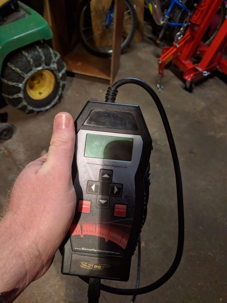

And my new to me SCT x3. It is unmarried, I already plugged it into my computer to power it up and make sure. So now I just need my code off my PCM and I can get a tune. Thinking of getting Lasota to do it. Lonnie did the tune on the car now, but it's an add on chip, and he never replied to me about getting it reprogrammed. He did the tune on my last Thunderbird, and my 99 Mustang GT. Never got to use the Tbird tune, as the car was totaled before the PI swap was performed. If y'all have any recommended tuners, I'm listening.

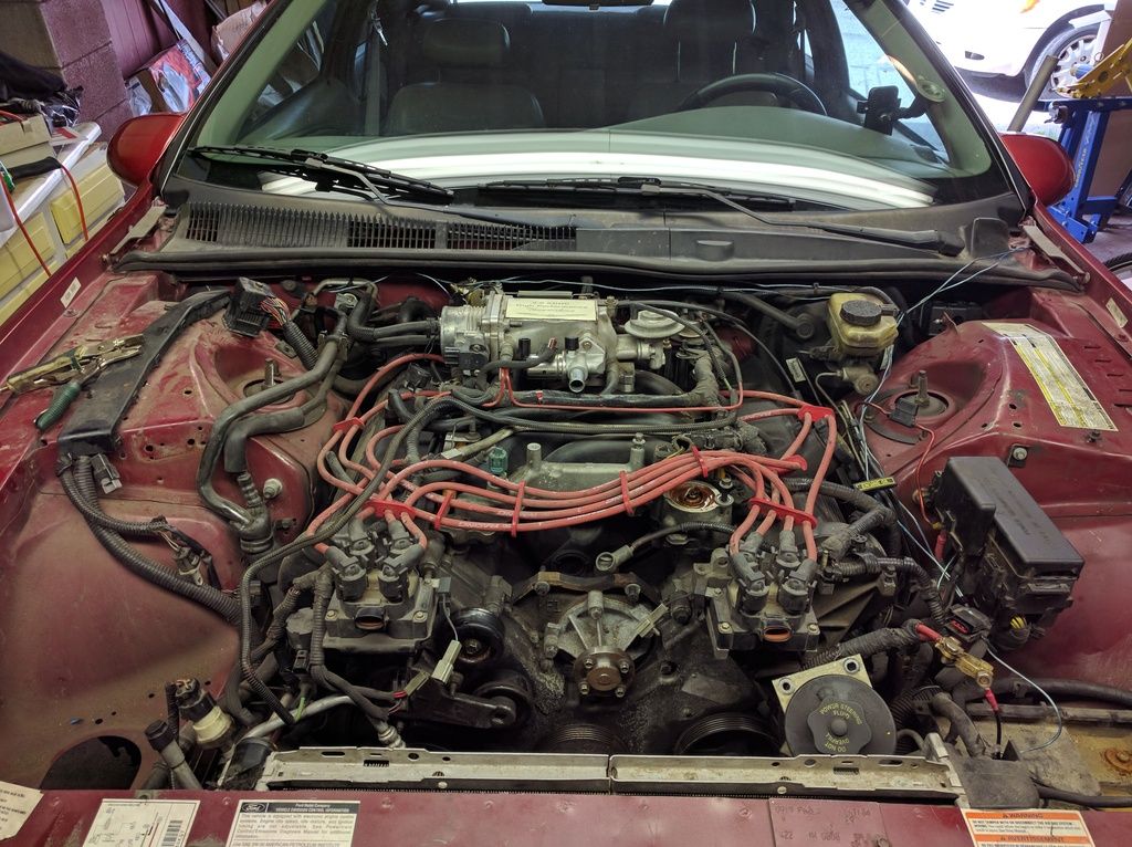

Since this picture has been taken, I've also removed the plastic cowl and the windshield wiper assembly beneath it to gain more access.
Not sure if the exhaust is bolted up "normally" or not, but on the driver side there was one nut on the bottom, and the other one appears to be reversed (or broken off... I'll shoot a picture later). Thankfully, Traveler kept the GTBird very clean under his ownership, and I've followed in his footsteps. The exhaust nuts are coming right off (I did spray them with penetrating oil just in case). Let's hope the starter is as easy too.
All fluids drained. Main harness near passenger fender unplugged. Fan is out, alternator is out, water pump pulley is out. Battery is out, I'll pull the battery box too. While the engine is out going to re-route some wires to keep them away from the exhaust.
I did notice on the driver side of the block, there is an unused sensor plug in near the freeze plug between the oil pan and the exhaust manifold. I'll take a picture. No idea what it is, but it has no cables near by.
Also found out the GTBird apparently adopted a pet over the winter. There was a chipmunk nest under the cowl on the driver side. Traps will be laid this winter.

Yes, the one exhaust stud going the other way is normal on the 4.6 birds.
As for the starter, my advice for that is leave the bottom bolt tight until the upper 2 are completely removed. People tend to pull the easy one first and then the weight of the starter fights you removing the upper ones that you can barely reach the whole way. I always use a swivel and a 4" extension on the top 2, break them loose and then remove them the rest of the way with the socket on the extension by hand, and then use a gear wrench on the bottom bolt last. Doing it this way, the starter is a piece of cake.

Originally Posted by Woodman View Post
So far, fan out, engine drained of coolant/oil, alternator off, water pulley off, radiator hoses disconnected, engine harness disconnected, wipers out of the way, other than unbolting the transmission and the exhaust/starter, anything I'm missing before i hook up the hoist and unbolt the motor mounts?
Don't forget the power steering pump pressure line.
Woodman likes this.

Posts: 1,171
I didn't see A/C compressor mentioned. On some cars, you can just unbolt it from the engine and leave it in the engine bay to maintain the charge.
Also, what about o2 sensor wires coming from the harness? Found that one the hard way on my Toyota.
Al
I removed my AC Compressor last year due to being locked up. Have a bypass pulley installed. I will make sure the O2's are unplugged though, thanks!
