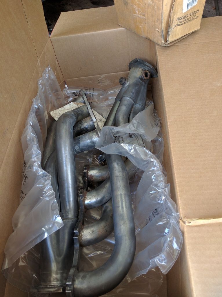

And look what came today just before I left for date night with my wife...
Going to mount the old manifolds onto the pipe, set these beside them, and measure up where to cut the pipes.

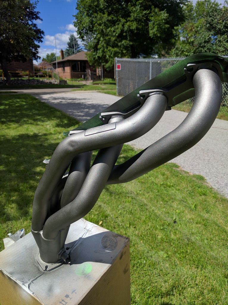

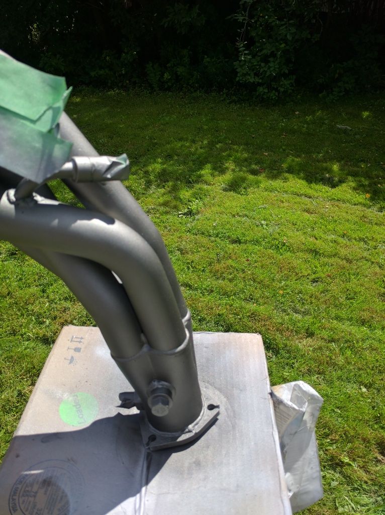

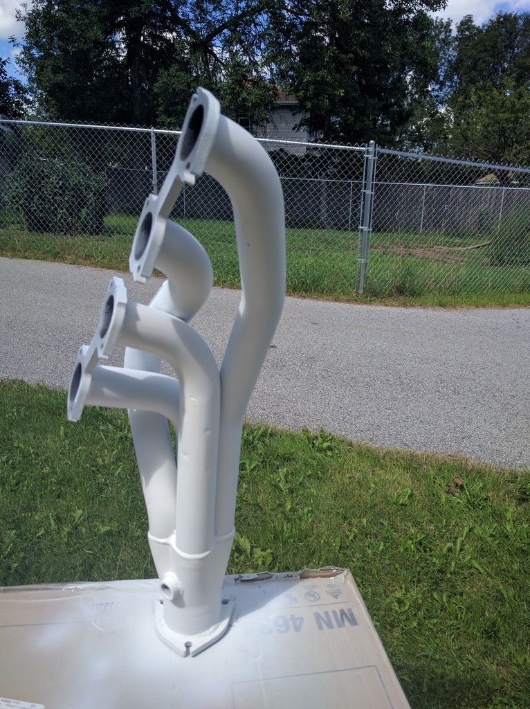

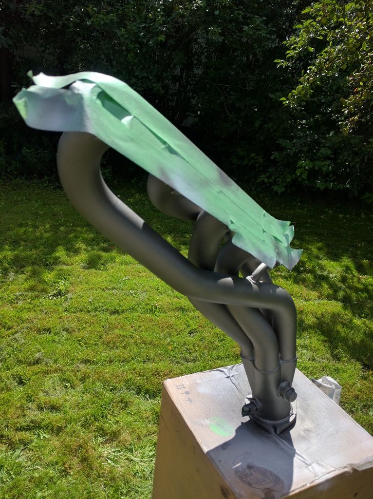

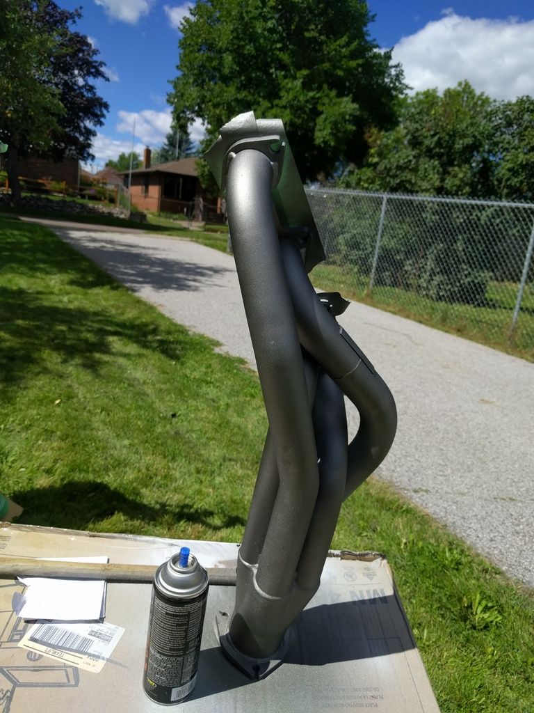

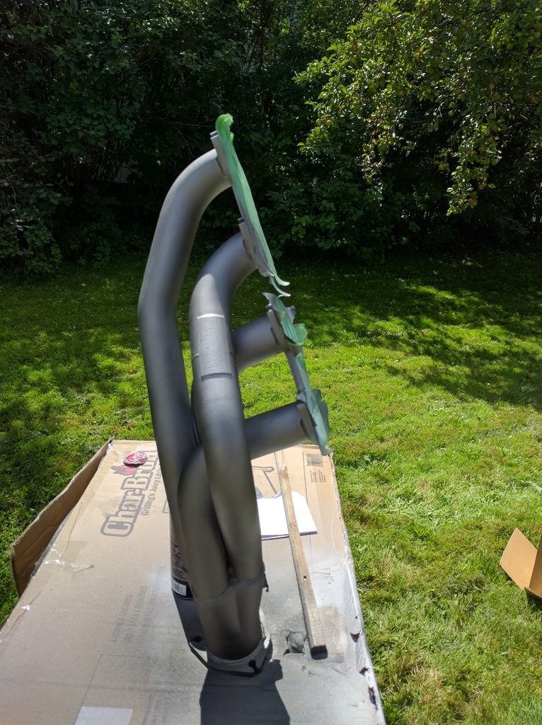

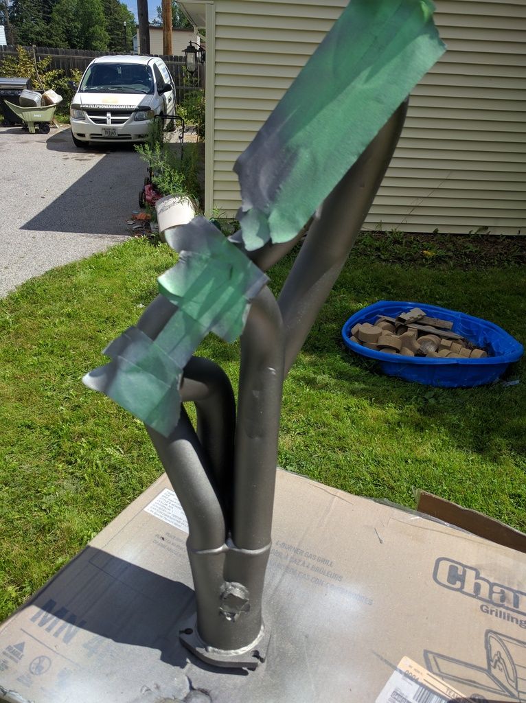

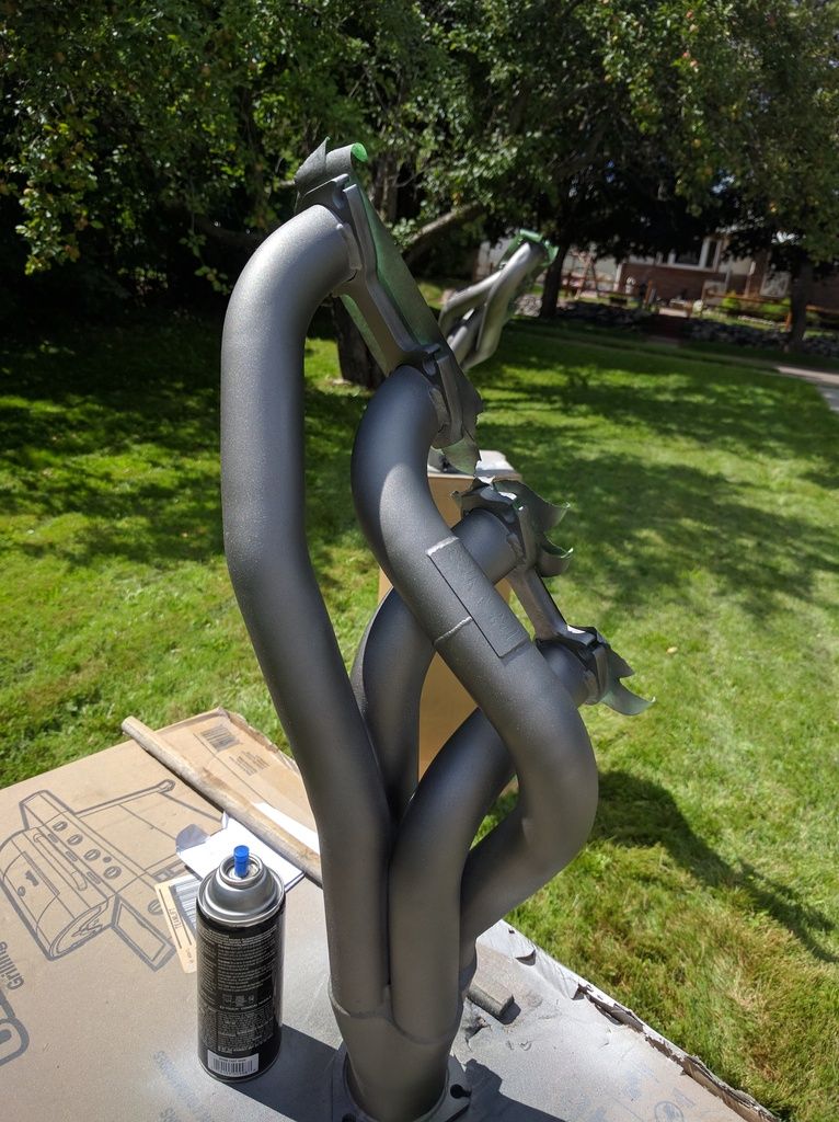

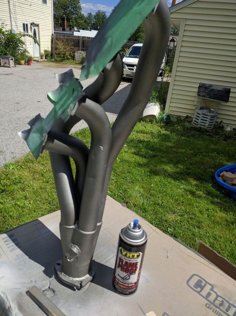

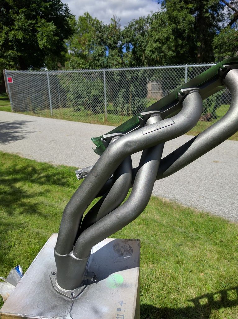

Headers are primed with VHT Flame Proof header primer. Iron Grey VHT Flame Proof will go on next, then cured in my old gas grill

Today's progress... Painted the headers with VHT Flame Proof header coating. It's supposed to be a ceramic coating, keep the heat in without trapping moisture like header wrap. I'm planning on getting a heat shield for the starter just in case, but I figure it's worth the time getting it done.
I'm no paint guy, and headers aren't the easiest things to paint by any means, but other than a couple of drips and runs, it looks pretty good if I do say so myself.

Headers look good, should actually stay that way too since Kooks are stainless. I'm dubious about the insulating effects of the paint though, it's not a real ceramic coating by any means

After spinning a rod bearing on 5w20 I'm never running oil that thin ever again, I'm using Rotella 5w40 on my build.
Duly noted. 0w30 it shall be.
These Kooks are definitely NOT stainless. They are the ones that came "Jet Hot" coated (which baked right off under the previous owner's ownership) and they had spots of surface rust on them already when I got them. Nothing a few seconds worth of sanding, then cleaning with acetone, then wax/grease remover, then VHT Flame Proof primer and paint.
They are Kooks though, they have the stamp on the top tube.
