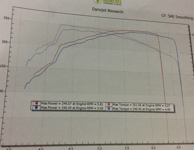

I agree that black cobra intake with the lincoln logo looks great. How much did it help the hp?
Not sure since I didn't have any prior numbers and admittedly haven't had it tuned for the intake and IMRC deletes either.
