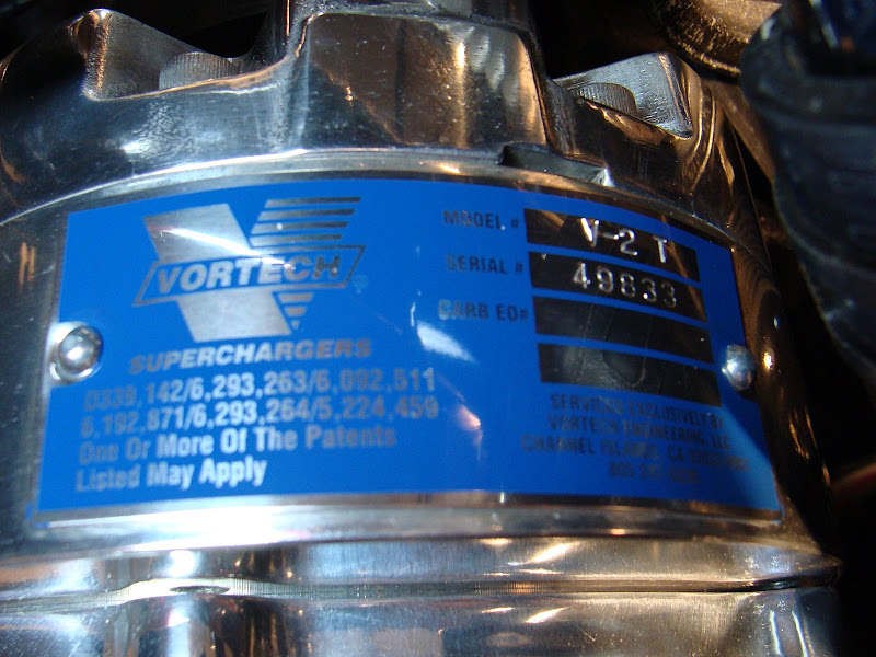

Talked to Ryan, and he said the blower made it back to Vortech. After talking to the Vortech guy, everyone agrees The Mark needs a t-trim.
For now, they are going to pulley it back up to the Reichard Racing 3.1, since I already have that pulley. Vortech said I should be able to make around the same amount of boost using the 3.1 on the t-trim, as the 2.7 did on the s-trim.

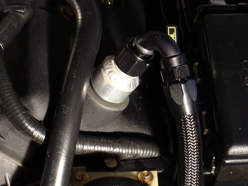

The Mark is going back to Aric's shop tomorrow to have the new T-trim blower installed, and re-tune it again.
They are also going to re-plumb the driver's side cam cover oil filler/vent so that it will now vent through a hose into the oil recovery tank hidden in the driver's fender. That should stop the oil spray from the cam cover vent going all over the engine and header.
And finally, they are going to replace that pesky aftercooler silicone coupler that kept popping off at SSHS8 last month.

The Mark is done. Just waiting for it's turn to get back on the dyno and dial it in for the T-trim. Ryan said they put a 3.3 pulley on it instead of the 3.1, and they are not going to spin the motor past 7k rpm's. There is a concern that fuel might be an issue now, so I guess we might see what the stock lines and rails can actually handle with the Ford GT fuel pump and the KBBAP.
I am really curious to see the dyno numbers and boost comparison between the s-trim and t-trim. Should make for some interesting reading.

The Mark is all done, and back at home now. The T-Trim ended up making the same horsepower as the S-Trim - except the T-trim is being under spinned with a giant 3.33 pulley on there while the S-Trim had a 2.7 pulley on it. Torque is down 20 due to the spool curve of that big pulley. Ryan is sending me the dyno sheet. I think the T-Trim made 16 psig at around 7k rpm.
The breather filter on the cam cover is history - spewed oil everywhere, and it has been modified to vent to the catch can /breather hidden in the fender now. The ipod is also in, and is now in the center console glove box.
Here are a couple pictures, and a video. Enjoy!
