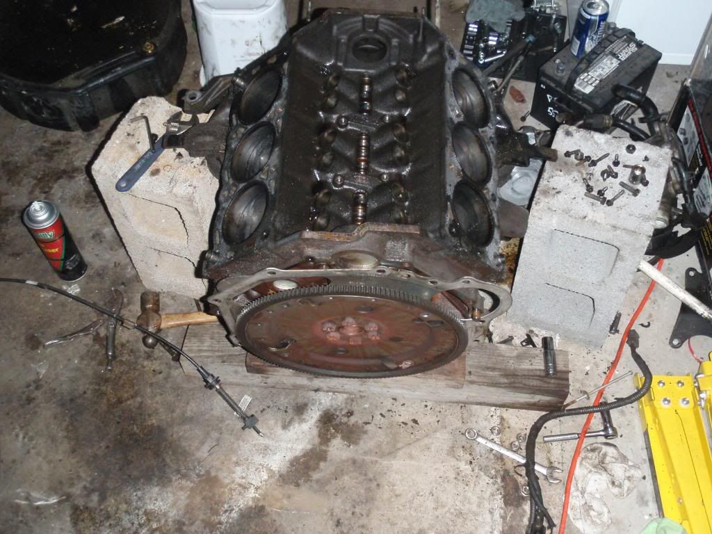

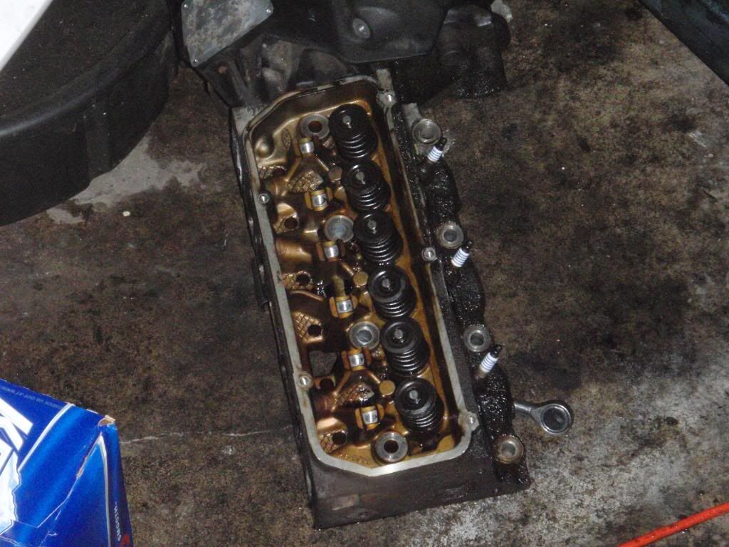

Buddy of mine (1_bad_bird) finally decided it was time to rebuild the motor in his sc bird! I've put in quite a bit of wrench time on it so far getting the motor ready to come out! Everything is outta the way not so all we gotta do is get a cherry picker n pull 'er on out!
i'll get a list of what we're gonna do to it! or have done to it!

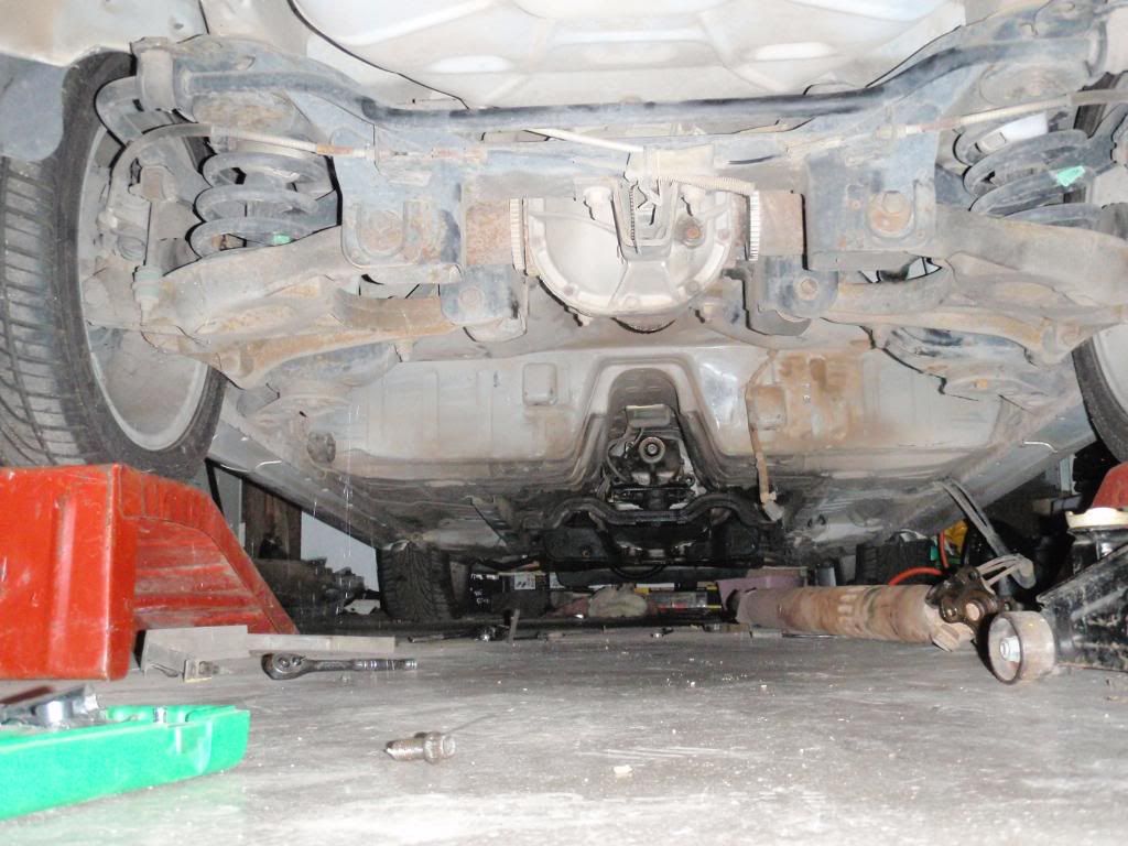

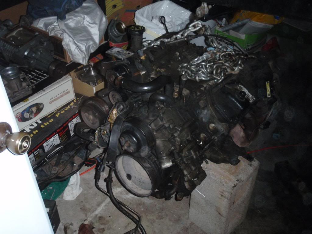

More pics:

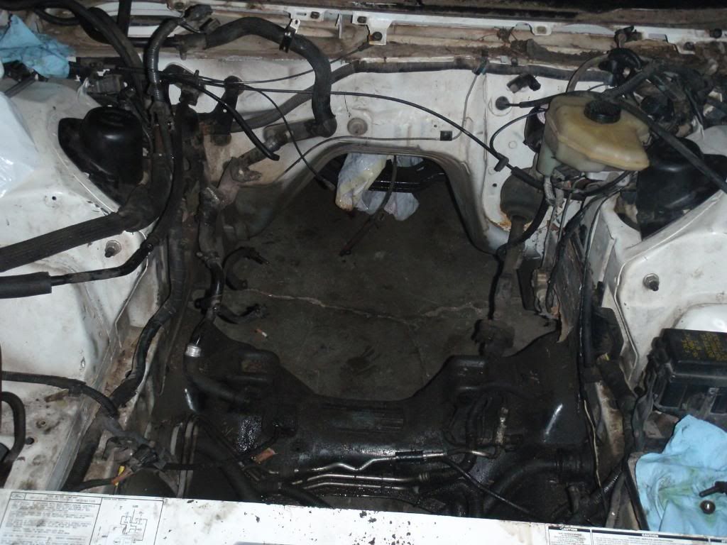

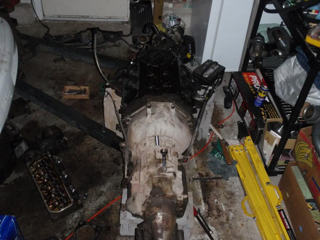

Got the motor and tranny seperated. flywheel has a couple of chipped teeth on it... no biggie. gonna be trashed anyways. used aluminum cobra pumkin came in last friday with cobra half shafts... tranny will be sent off and rebuilt. motor is going to be bored i believe 30 to 40 over... my buddy dave got a quote from marc brown at advanced engine... marc said he can build us a 450hp motor for around $4,500 that 450 is just the motor, it does not include the supercharger and other goodies. supercharger will be ported... ummm not sure what else is in store for it. probably going to look into a snow meth kit like jobe has... i'm shooting for 550 to 600hp when it's all said and done. we'll see what happens.
more pics...

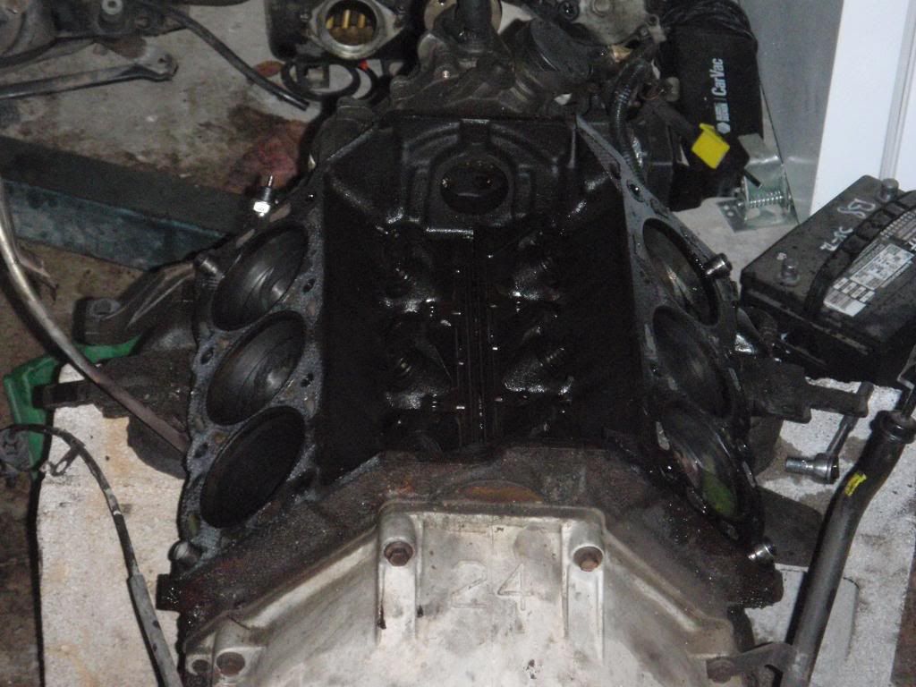

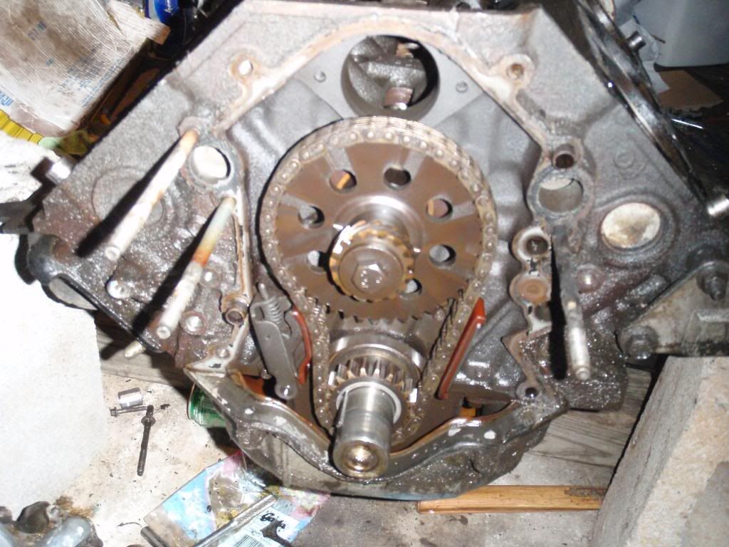

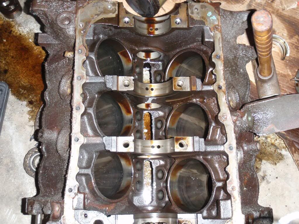

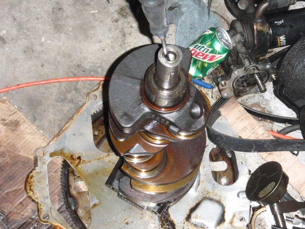

crank, cam and pistons are out... no metal in the oil pan! you can still see the cross-hatching on the cylinder walls. pistons kinda look like **** but everything else looks really good! like (motor has been re-worked recently) good. regardless, it's ready to be sent off!
pics:
