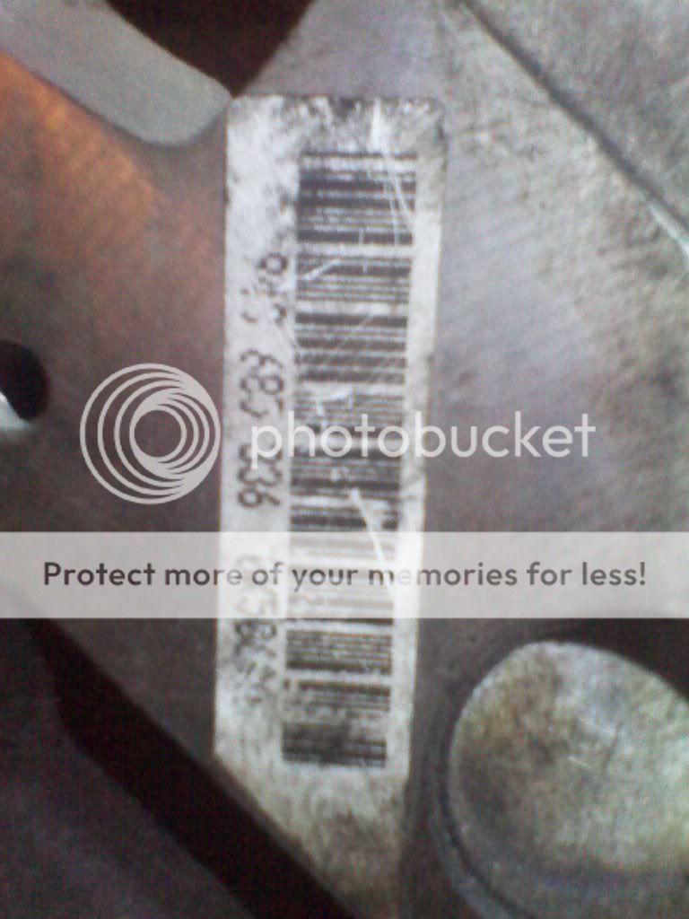

Here's the barcode on the back of the driverside head.
I've also noticed a few E9 part numbers on a few of the front brackets.
I'm such a novice with the SC stuff so I really appreciate all of the help from anyone who knows. The valve covers are non-magnetic so I'm assuming I've isolated it to an 89 to 92. If anyone could point me in the right direction as to where I would find the block numbers I'll start scrubbing the filth and type them up here for decoding as well. I don't think I'm over my head just yet. I'm too determined haha.

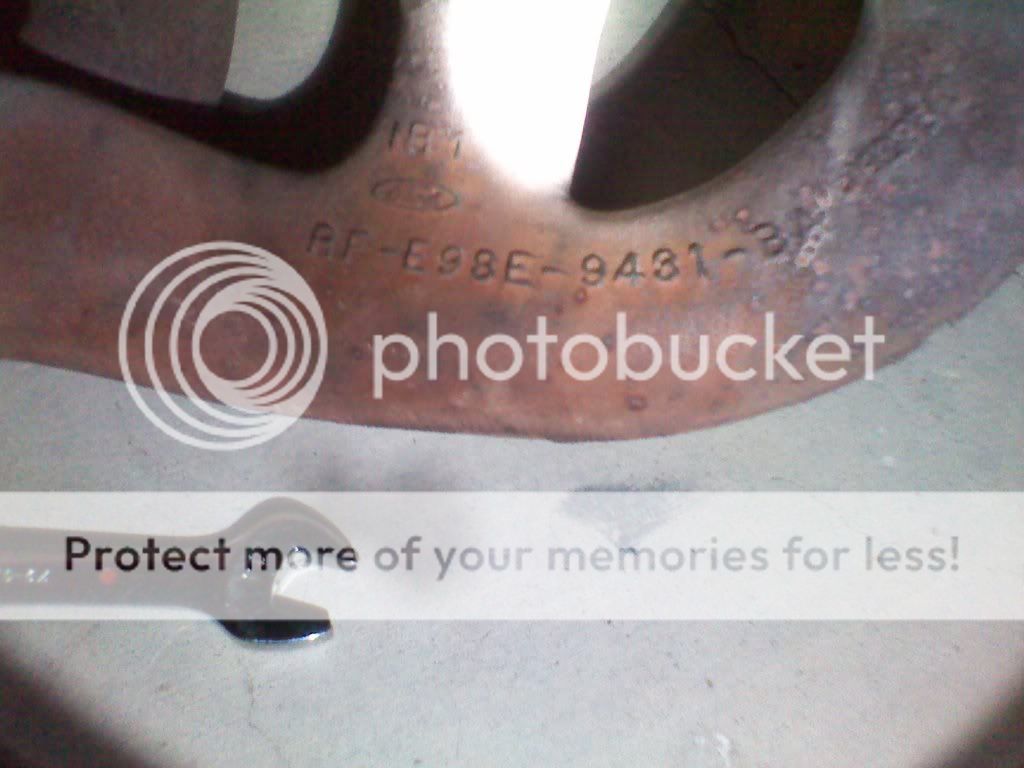

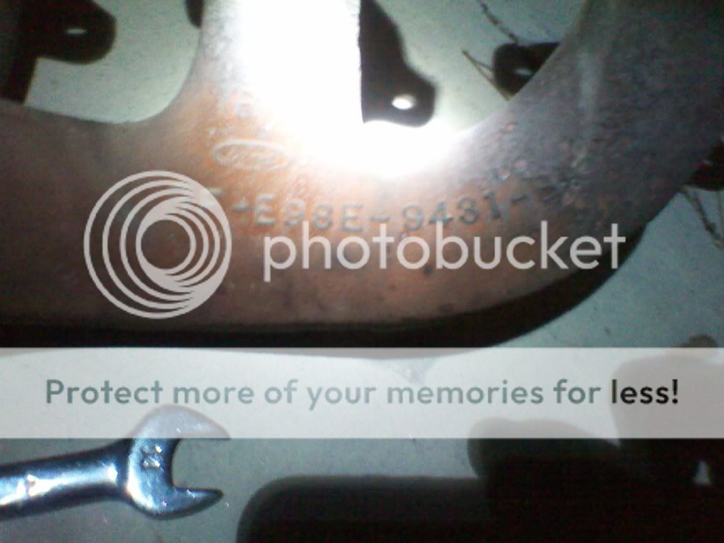

2 night flashlight lighted pictures of the drivers side manifold... of course no idea if that is original to it either since it didn't even have gaskets under it.
post #11 of 20 (permalink) Old 05-11-2012, 12:51 AM
dDUBb's Avatar
Location: Nor-Cal
Posts: 4,139
They didnt come with gaskets from the factory - the machined surfaces were nice when they were brand new.
Looks to be 89-91.

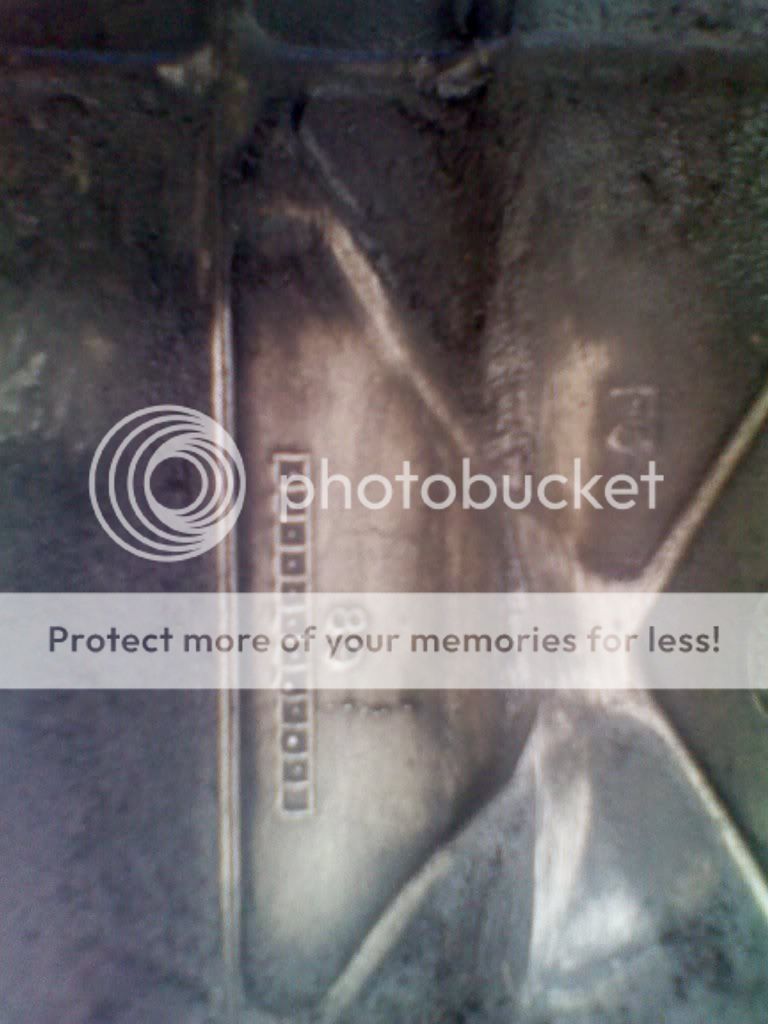

Look under the oil pan, near the part number there should be a year stamped on it and a row of boxes with dots .. that would indicate Year and month.

post #13 of 20 (permalink) Old 05-12-2012, 02:24 AM Thread Starter
Posts: 5,408
post #14 of 20 (permalink) Old 05-12-2012, 03:16 AM
dDUBb's Avatar
Location: Nor-Cal
Posts: 4,139

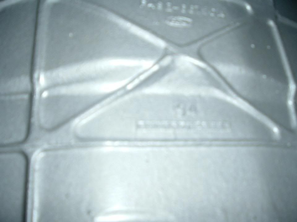

Hard to see, but it was made in July 94 on a 95 engine.
Check a little to the left ... more forward, in the next square of the casting.

post #16 of 20 (permalink) Old 05-12-2012, 05:04 PM Thread Starter
Posts: 5,408
So... I'm guessing it's the last production of 89? November 89? Dura crank or forged internally balanced? I'll need to know to get a flexplate and balancer.
post #17 of 20 (permalink) Old 05-12-2012, 05:33 PM
It would have gone into a 90 sc at that date. Then again ford isnt consistent with things.
post #18 of 20 (permalink) Old 05-12-2012, 07:53 PM
dDUBb's Avatar
Location: Nor-Cal
Posts: 4,139
Well like I mentioned above .. my 1995 SC has a Born on Date of June 26th 1995, but the pan was cast in Mid-1994. So I would say its pretty fair to assume it came out of a 1990 model, very unlikely it has a duracast crank, those were changed mid-year in 89 and your pan was cast very late in the year.
