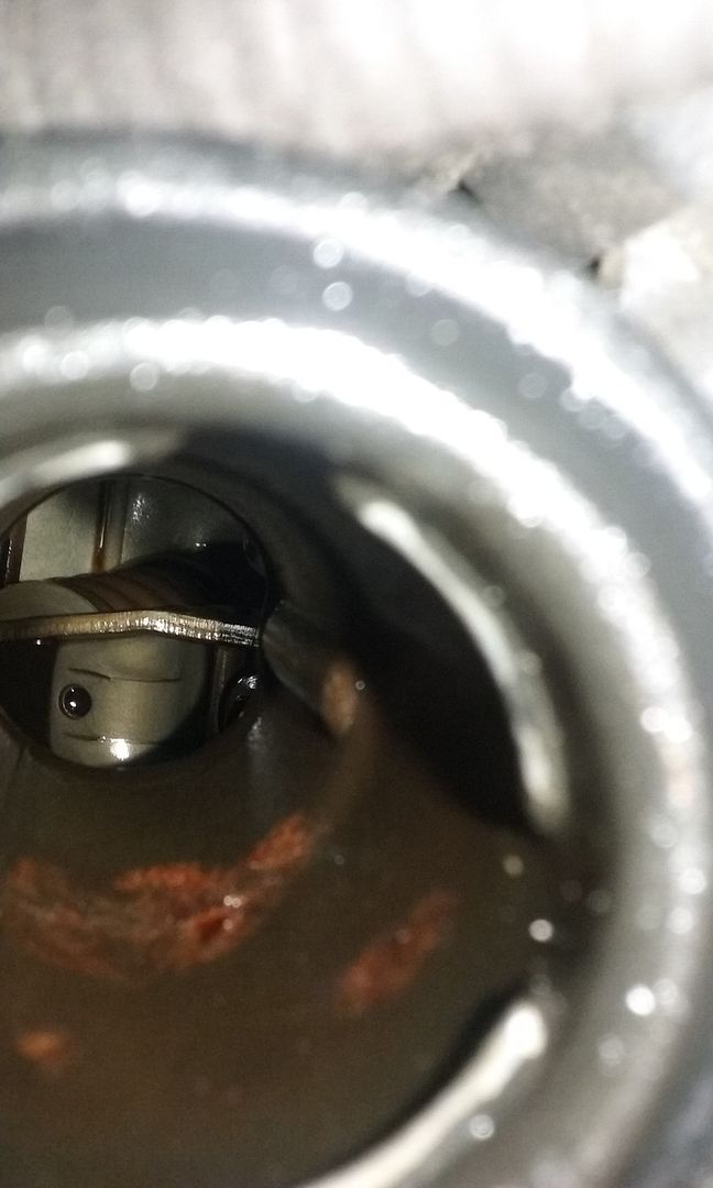

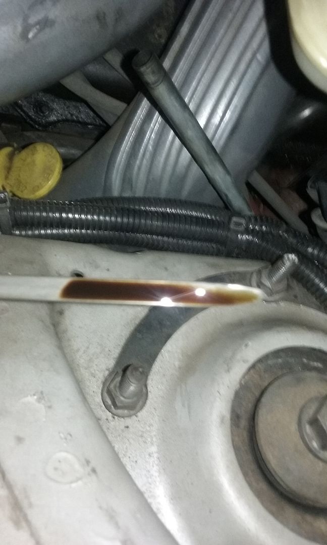

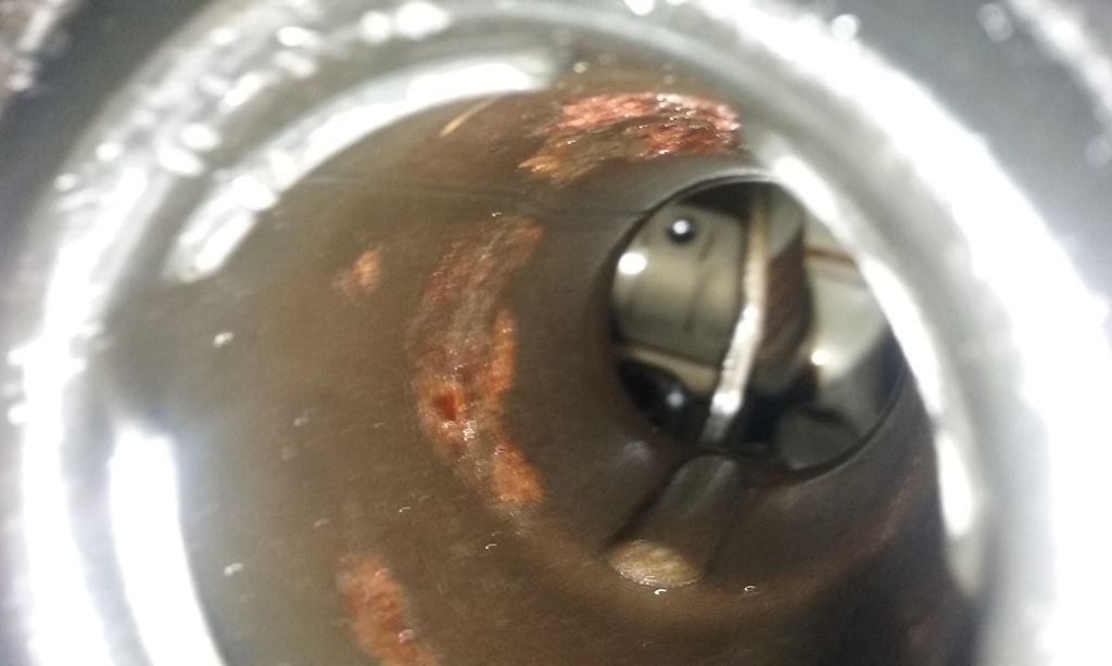

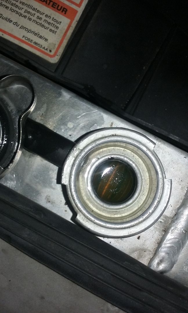

I just got my car smogged monday and the next day I drove it 5 miles and I noticed that the temp gauge went up to 3/4. I tried starting it 20 mins later and it had a rough idle. I started it 2 1/2 hrs later and drove it for 5 mins. Im not sure what the problem is but here are some pics maybe someone can help me out.
I think there may be deteriorating rubber in the coolant, I had that problem in my 89 base. Ill change the coolant and the fuel filter soon and clean out the reservoir soon. I think the thermostat may need to be changed. The rust in the valve cover where the oil goes in may be from condensation, I don't know. Thanks for everyones help.

A rough idle after high temperatures or an overheat could mean there is coolant entering the combustion chamber..
Considering how notorious 3.8L are for blowing head gaskets..
You might as well rule that out by testing the coolant for any sign of combustion gases..
Napa sells a Leak Detector Kit that you can use to test the coolant for any signs of combustion gases..
Click Here-->>Leak Detector Kit
It's pretty easy to use, even if you've never used one before..
There's a few video demonstrations of people using the combustion gas Leak Detector Kits on YouTube as well..
That's just one way to test for a blown head gasket..That's if the gasket blew in that manner..
Check your oil level to make sure it does not rise..
If the head gasket blows in a manner where the coolant starts mixing with your oil, you can say goodbye to your bearings..
I hope it's not a blown head gasket, but you might as well try and rule that out..

I bought that tester kit and the engine was good. I noticed when I turn on the AC the temp goes way down. Lately I haven't got any bad idle problems. Thanks for the tip rayo.
