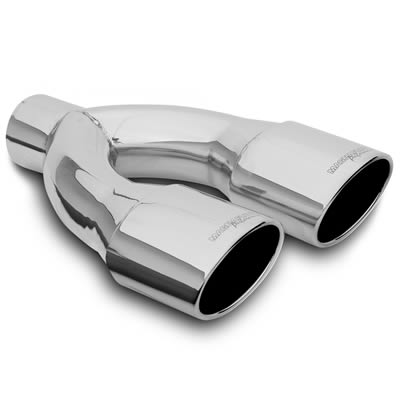

Thinking something along the lines of this:
but I need to find a better price than 200 bucks!
You have no idea how hard it is to find a 3" INLET dual tip! I see now why magnaflow charges 200 bucks! BECAUSE THEY ARE THE ONLY ONES WHO MAKE THEM!

Originally Posted by Grounded Eagle View Post
Yeah I saw that, But if you look closer its slanted, its meant to be used with another one like it, for a simulated quad tip...
~MG~
yeah i noticed that after i posted it, you might want to hit the junkyards and look for like older grand am gt's and maybe hack one off one of them, just a thought
