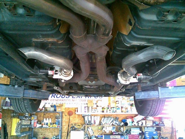

The proof is at the track.
Not long after the install, I had a good opportunity to test the setup at a private rental. Open vs. closed, open was consistently faster.

no, i meant the 6" straight pieces, kinda useless....the angled downtubes, yes
i know there's a point in dumping, lol, as i too am running cutouts....great for making lots of noise, lol, didn't make it any faster, guess i didn't put enough restrictions in my exhaust, lol
driller-thats a mighty low time for that power....what converter u runnin, how light is ur car...sorry to change the subject

The proper question would be how heavy is the car. LOL
Race weight is generally 4050 pounds depending upon fuel level.
But in full disclosure, the 13.4 was with a negative density altitude. I generally run 13.6-13.8 depending upon the track and weather.
The remainder of the exhaust is basically wide open. I'm running Hooker's mufflers that are open straight through. The only restriction would be reversion at the cutout Y pipes when the cutouts are closed.
One of my dreams is to rig a WOT switch and timer to hold the cutouts closed for a time yet to be determined before opening the cutouts at higher rpms. I believe it would be possible to utilize more torque at the launch then less restriction to HP once the cutouts open at the higher rpms.

post #22 of 29 (permalink) Old 04-21-2008, 01:50 PM
Posts: 129
my setup.....
dude dont you need a hpipe/xpipe?

post #23 of 29 (permalink) Old 04-21-2008, 02:03 PM
nope.....
post #24 of 29 (permalink) Old 04-21-2008, 02:13 PM
Posts: 129
nope.....
y not? doesnt it help equalize the pressure and help pull the exhaust out better/scavanging? im just curious cuz i always heard it was bad.
hourang is offline
post #25 of 29 (permalink) Old 04-21-2008, 03:39 PM
I have no need for it with my setup.
For one, as you can see my exhaust pipes are very short...around 12" of pipe per side.
I also run longtubes to help with the scavenging, and I run a carnkcase evac kit, which helps provide better ring seal...I was thinking of putting one on, but, it has been fine with out it..
in the pic, you can see on both valve covers, there is a chrome breather on each, and off of those a black hose is attatched, which leads down to the header collector.(those are part of the crankcase evac kit)
post #26 of 29 (permalink) Old 04-22-2008, 09:17 AM
Posts: 129
hrm makes sense. your probably fine considering a lot of carbed cars run open headers as long as its calibrated for it.
on a side note, i ran my camaro open ypipe for a while and it was fine without a muffler. until i added a single bullet straight through muffler, and it picked up a boat load of low end torque. night and day difference.
