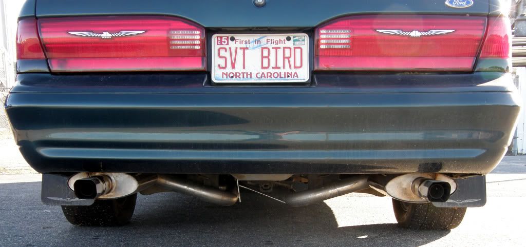

Are you talking about the tips in your 15th picture in your gallary? Bc I really do like those. Where are your mufflers located? Thanks for the help.
