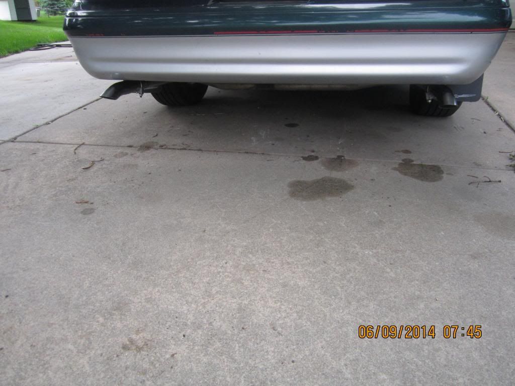

one thing i failed to realize... the factory mufflers actually drop the turn downs about an inch internally. the pipe comes in the back, and then comes out an inch lower... which leads to this
hopefully it doesn't melt the bumper skirt before i get a longer pipe hanger to drop the pipe a bit. their not touching, but its only about a half inch clearance...

It sounds fine without mufflers, and it's pretty subdued(though I had the resonator in tact with mine). Plus blowmasters aren't going to improve things much.
Don't worry too much about the tips, on my initial muffler delete they actually were resting on the bumper cover and they only warped it a tad after two years of daily driving.

Posts: 1,273
that's good to hear. i just didn't want it to melt away or catch fire while i was rolling down the road

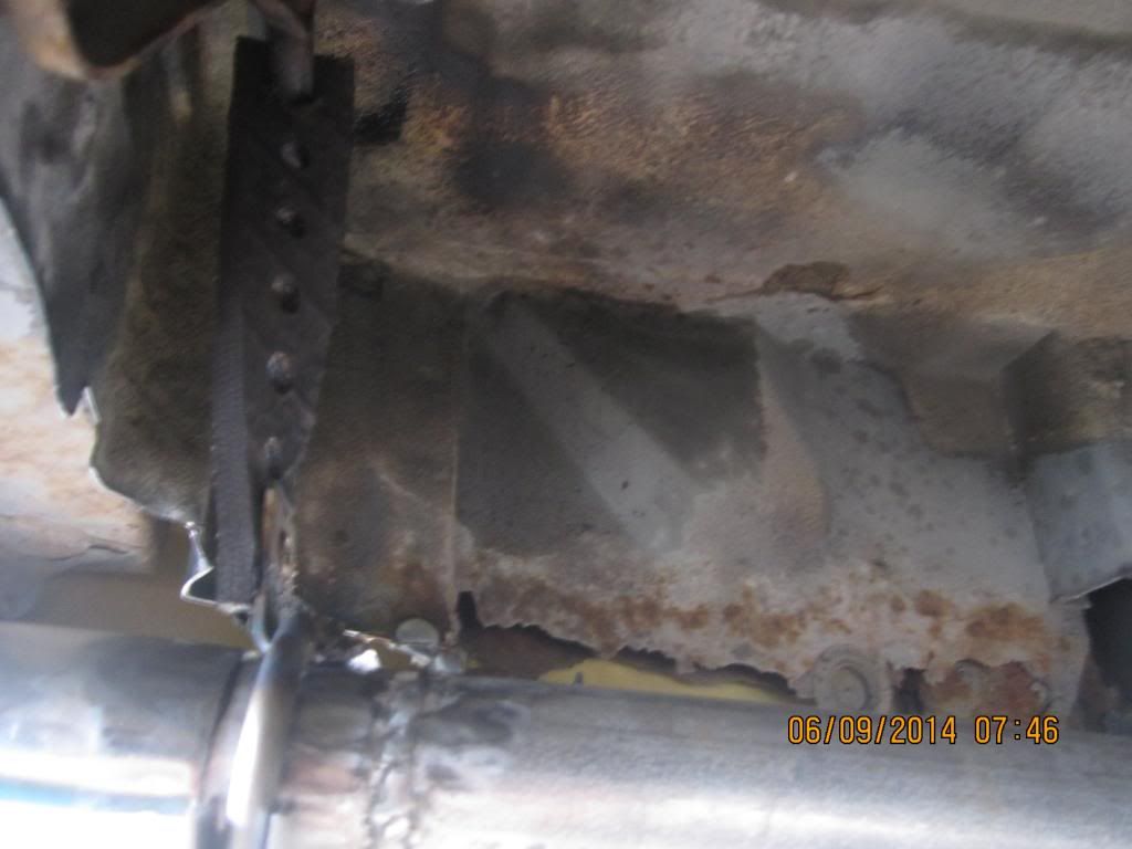

well, after i had to drop the whole pipe assembly again to weld back on 6" of pipe, i figured out how i was going to hang it all.
it was rattling quite a bit today, so i picked up two ROL rubber strap hangers. disconnected the rubber by the differential, and dropped down the whole pipe a bit. welded the strap hangers to the 2" clamps because i was worried they might twist out. and hung it up like this.
pay no attention to the rust hole behind the pipe!
otherwise i think it looks a lot better, and it doesn't make a sound when kicked anymore
I have the muffler delete, but DO have the resonator and my tips are touching the bottom of the bumper... Setup was from a previous owner and I've had the car for over 3 years now and no melting has occurred as of yet.
Just my 2 cents.
