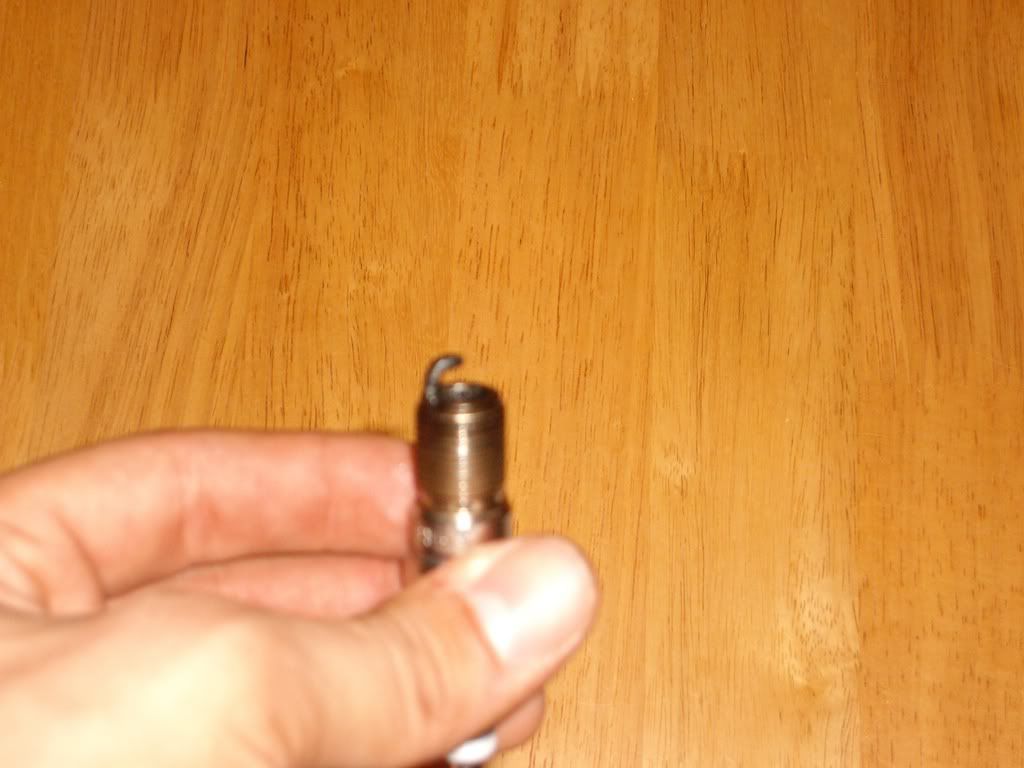

well turns out that its not a lemon but bosch plugs are now on my $#!T list
these are the plugs out of my #1 and #2 Cyl
notice how the center is gone from the #1 plug
and how its still there in the #2 plug
try and guess where the center of plug #1 went.....ill give you a hint.... cyl #1 has 15 psi on a compression check and the rest have 125psi on the same check

Ouch. These engines can be rebuilt on the cheap. I know a guy here in Ashland (PTI Racing Engines) who does outstanding work. Im finishing up the R&R of a 4.2 in an f150 that he did the machine work on. That engine was beautiful. He's an ex-nascar engine builder so your engine would be in good hands.

may have not been the spark plug that knocked a hole in the piston heres a pic taken right after i lifted the head off
the little white specks are whats left of the center of the plug

holy crap, i havent used bosch plugs in a long time and always thought i got worse performance from them over a projection tip plug but i never knew they had problems like this!
