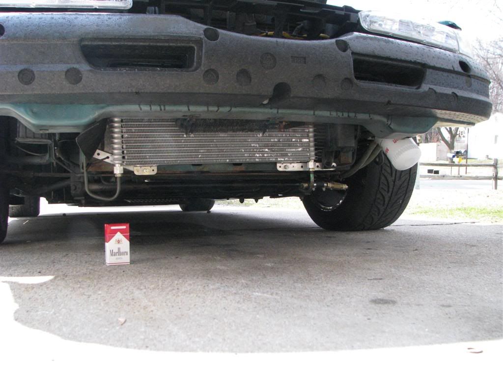

does anybody have pics of this particular set up??

is that close enough?

close enough dude thanks...now i have an idea of what i need to do.
