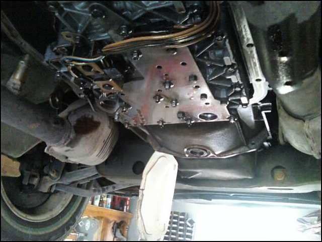

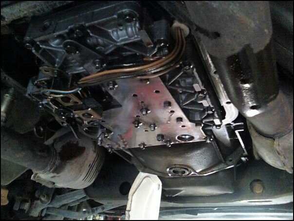

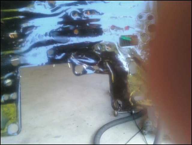

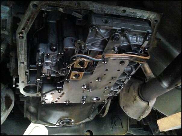

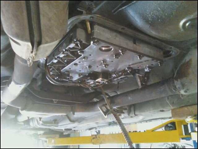

Pictures Please!!!!!!
I have the pan dropped, and the valve body dropped but my manual is very weak and does not show any pictures of what im looking for. I am specifically looking for the solenoid for the TCC and im looking for the TCC itself. This is on a 1995 Thunderbird V8. Again i am having trouble with hard but sloppy shifts and I pulled a code for the Torque Converter Clutch Electrical System malfunction. I have very briefly checked all the conections on the harness and found no apparent flaws or problems, so i decieded to dive in a little deeper. I need to know where to start looking and what to start trying to replace without turning this repair into a small fortune. I will be posting picture of where im at in the process and if you could sokindly point me in the right direction of this repair. Thanks for all you help in advance guys, i need to get this car running right again and soon. So if any of you out there have pictures of either replaceing these things or just pictures of where the are loacted that would make it much easier for myself.
Tim
IS THIS A PROBLEM!?!?!?!?!?!?!?!

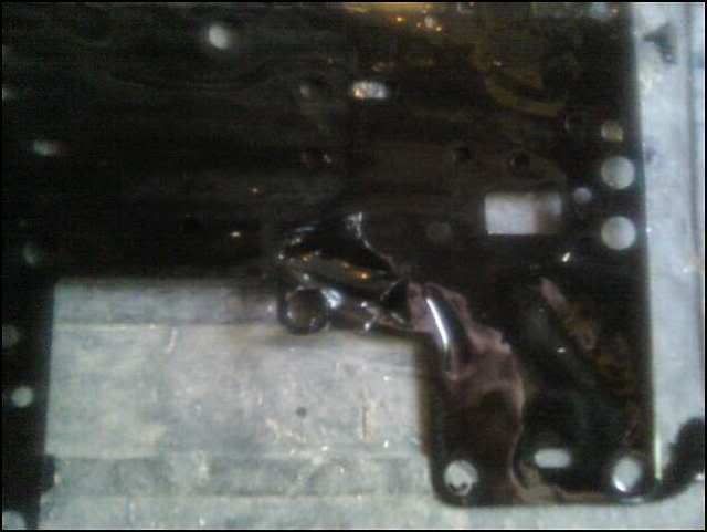

SAME PICTURE DIFFERENT VIEW, ANYONE SEE A PROBLEM HERE!?!?!?!?!

Why did you drop the valve body? That was completely unnecessary for replacing the TCC. Looking at what I said above, I never mentioned removing the valve body, so I hope you are j-modding or replacing the 2-3 accumulator or you just did that for nothing.
This is the TCC solenoid:

What I circled IS the TCC. If the resistance checks out ok, it might still be bad, but carefully check all the wiring both inside the transmission and out. You might need to tear the external harness that goes around the transmission apart and check for problems.

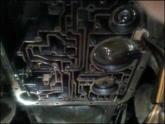

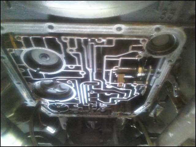

Anyone Up For Assisiting In A J-mod While Im Here????
Also my gasket for the valve body seems to be screwed up, can you buy these seperate?
This is the gasket you do the j-mod to correct?

Replace it if you can't find anything else wrong. Replace the 1-2 and 2-3 accumulators if they are the original design. Use the appropriate springs in the 1-2 and none in the 2-3. And j-mod the valve body. And install a tranny cooler.
