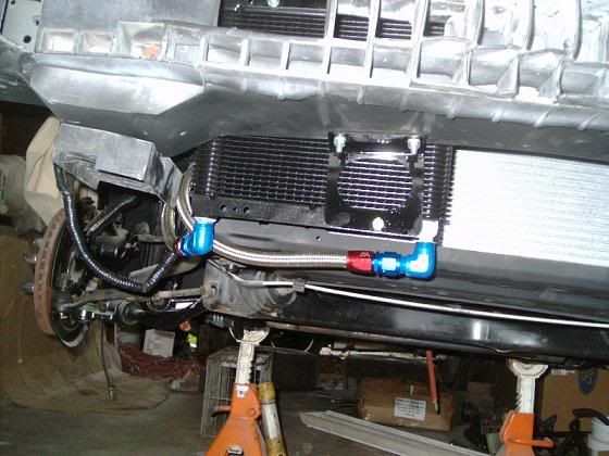

here is where i put mine...

What is the brand / specs on that trans cooler? That's bigger than mine

# 4739-1 Tru-Cool MAX transmission cooler 8-1/2 x 22-3/4 x 1-1/4 inch

The heat is a building issue. You can run it hard for short times and it won't get that hot. I usually level out at 185 with my 45000 Tru Cool Max and aluminum finned pan after about 3 hours running 80 mph with the AC on in this 95 degree heat. I have no radiator cooler though, only stand alone cooler and it is on front of the AC condensor like Vics.
