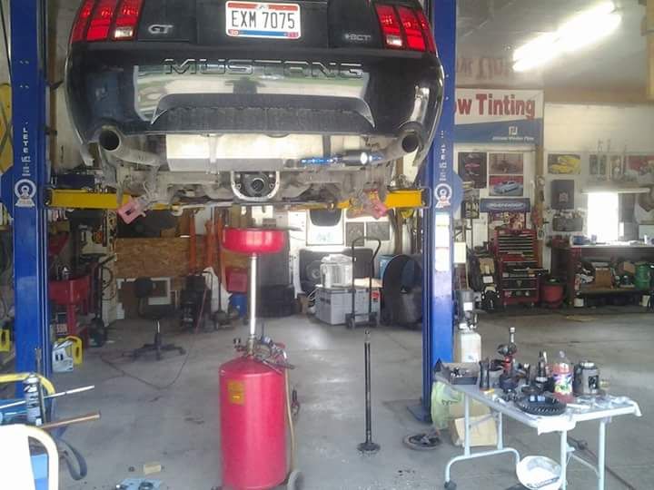

A good friend of mine I went to school with has a built 2001 Mustang GT that was having issues shifting out of 2nd most of the summer and his Mustang makes serious power. It puts down 630rwhp and 570ftlbs with a T-trim blower, Holley EFI on a Coast High Performance built stroker. Somehow he's stil using a stock T45 although it probably the 4th one. its been really hard to get into 3rd and 4th gear and when he came to my garage for the test drive he passed a car and went for the 2-3 shift.... Nothing, stuck in 2nd gear and drove 6 miles to me in 2nd gear. Got the trans out and the 3-4 shift fork is broke. Replacing it means the entire transmission has to come apart and the the gearsets have to come out. Before this I never had a T45 apart but have done a ton of T-5s. Had to make a puller to get 5th gear off the countershaft but other than that it wasn't to bad. Just had to pay attention. If you're banging gears on a T-45 and miss 3rd way to much, its more than likely the fork and not your mad driving skills!

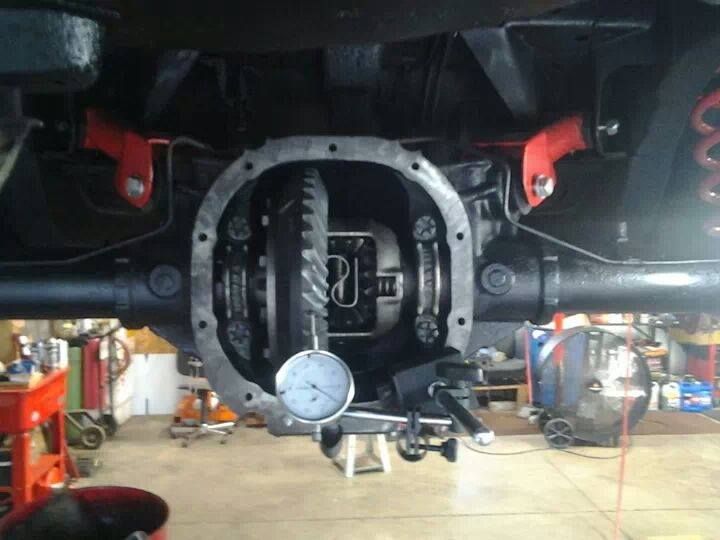

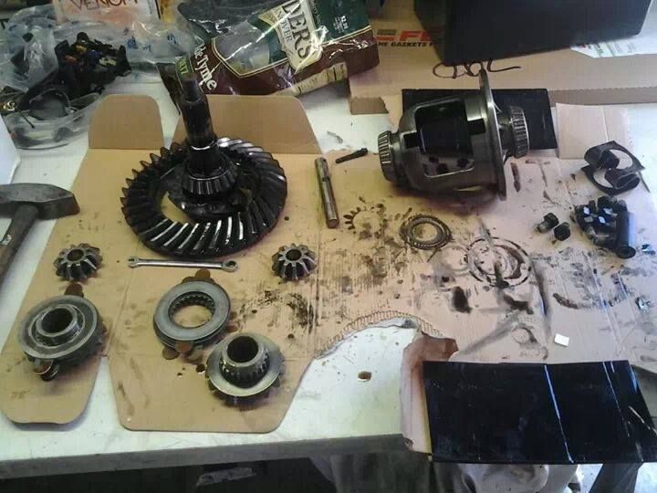

Also put a new carbonfiber kit in the rear, along with the 3:55s. Wish I had a better pic of the 410s but you can see how shiny they are. Only had roughly 20K on them but he drives this car hard and uses all 630rwhp every chance he gets. The wear in the pinion gear was pretty bad and very visible on the ring gear. From now on this will get checked every other month
