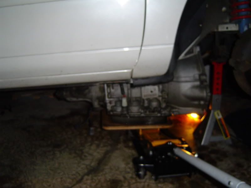

No trans jack, No straps, Nothing fancy... Just a board, a HF jack and a flat bottom pre 96 pan for installation. Perfectly stable too.

Posts: 5,408
I've used the pre 96/97 pan for install as well. Makes it easy.
