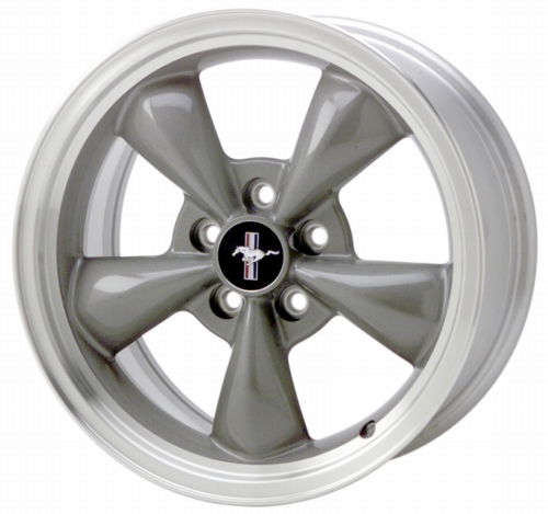

With the new bird with the 5x4.5 hubswap done comes the incessant need to get rid of the current rims and also upgrade to 13" cobra brakes in the front:
Here are my current thoughts on Buillitt (although I haven't looked into offset sizes etc.):
2005 Silver Mustang GT
6.295" backspacing
45 mm offset
17" x 8" wide
2003 Charcoal Grey Special Edition Mustang GT Wheel (doesn't match the 01-02 paint color-which I may have on my bird)
5-lug, 4.5" bolt circle
5.72" backspacing
30mm offset
17" x 8" wide
2005-08 Silver Mustang Wheel
6.82" backspacing
50 mm offset
18" x 8.5" wide
For Cobra R-17x9 or 17x7.5 Silver.
Any feedback appreciated.

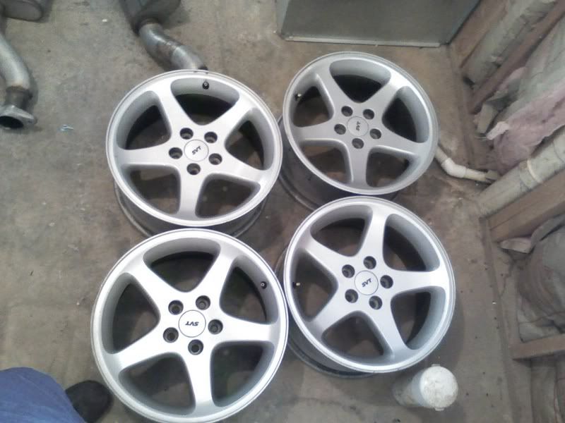

Posts: 16,644
found a pic of the 99 cobra wheels from the tccoa wheel gallery

I think either of the gray bullet wheels will look good. I also still think it would be worth trying to find some 10 anniversary cobra wheels from an 03 cobra. Some mustang forums to check out are corral.net and even horsepowerjunkies.com. I will check with my brother on others as he has an 03 cobra. He may even have a connection with some guys that want to get rid of their stock wheels.
Awesome! Thanks!
