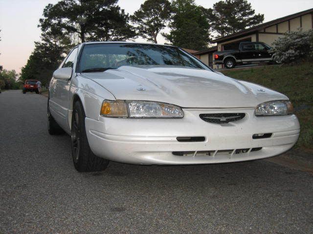

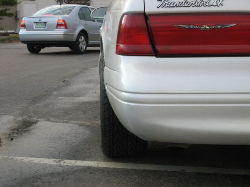

Here's 03 10th anniversary cobra wheels with 4mm milled off the hub to increase the backspacing. They fit just fine.

If I do my math right, I do believe that the wheels on my car have a 6.3" backspace after the 4mm was removed. They have 6.12 backspacing stock which is about a 28mm offset. After being machined this would bring it to a 32mm offset for a 17x9 wheel. Being as they are 9" wide, this would put the wheel approximately 3" out from the hub. Hope this helps.

The stock 10th anniversary wheel is a +28mm offset and has a 6.12" backspacing. The wheel with 4mm shaved would be a +32mm offset with a 6.25" backspacing and would have a 3.75" frontspacing. The wheels that Tx_Cat is looking at can't be shaved quite that much but should be able to be cut down enough to make them look acceptable (at least the 9" wide versions).
