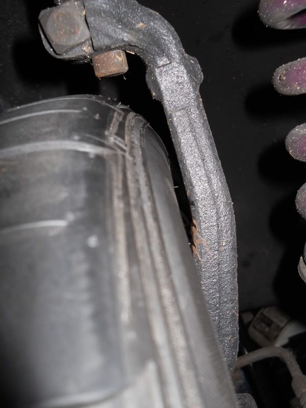

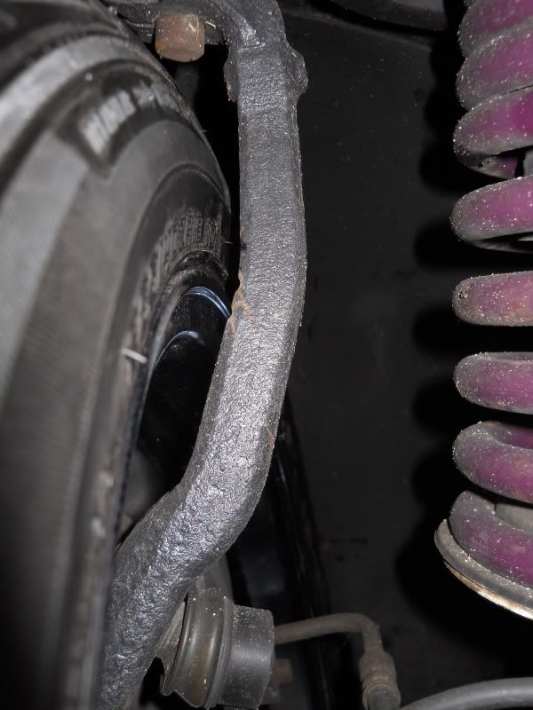

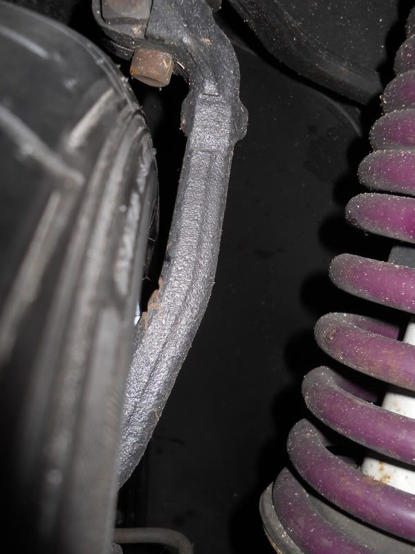

I got the pics up Ill just post them here. Offeset is crucial for this. Its tight but the contac patch will improve handling greatly. The cars are two tons of steel 245s was not doing it for me. I wont know how they feel till next season so use caution.
Rims are 36MM 18x9s Any variaton in that will affect your results. A lower offset will not be a problem but then your fender will start rub.
