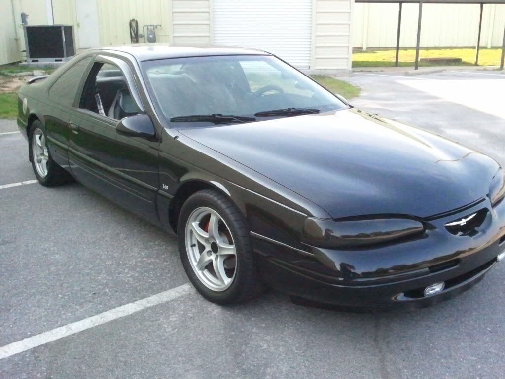

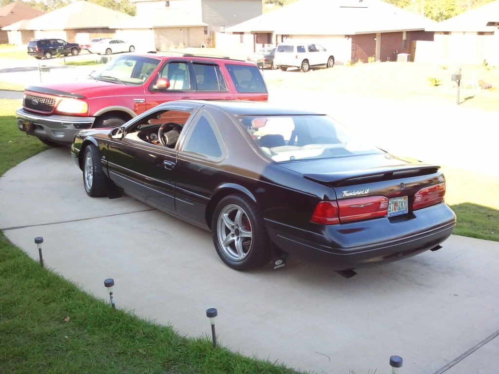

I have them on my car. I have the 98 Cobra rims and SN95 hub swap.

Ford stock Cobra 1998.
Do not stick out past fender.
Clear everything on all 4 corners.
Rims are 17X9 offset???
