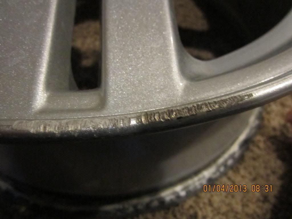

anyone got any advice on repairing a slight bit of curb rash on the bead lip of a painted factory wheel?
ive got a set of 1F22-1007-AC
but they are slightly rashed in places and ive been doing a bit of research to find a decent method of filling the deeper rash and matching paint on them. some people recommend metal filler puttys and fine sanding, etching primers, and completely painting the wheel since its devilishly hard to match the metal flake.
i was just wondering if theirs an easier method of doing this without painting the whole wheel, i mean the paints perfect everywhere else but the bead ridge...
its like the person driving the van was bouncing off curbs all day and night with it till they finally smashed into somebody + somebody else smashed into them...
(how the van looked when i dug the rims out of it and the local picNpull...)
one of the rash marks is about 6" long and maybe 1/8" deep. i'm not sure metal filler would hold up if the wheel weight ended up needing to be hammered onto it. don't have a tig welder or i would just fill it with alum rod and be done with it...

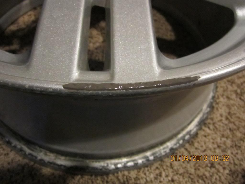

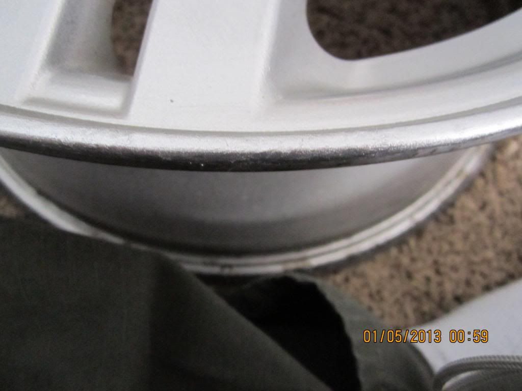

well, its not perfect, but its good enough for government work. just some JBweld, a file, some fine grit sandpaper, and some 'celeb city 220' nail polish, i was able to take this:
to this:
to this:
to this:
now i figure I'll spray some clear over it, and call it a day.
also: fixed the images so its the same rim, had the wrong completed one up their at first.

thanks, i hope they will look OK, and with the new life I've given them i can run em for quite a while.
just wish finger nail polish didn't dry so fast... if you keep brushing at it to spread it out it starts to dry immediately and then you start dragging lumps of it around the surface.

thinner eh? ill remember that. some lady told me finger nail polish is supposed to dry fast, so they don't have to stand their blowing on their nails for hours XD
and yeah, its should stand up to a glance from a few feet away, but if you got real close you can see some imperfections.
