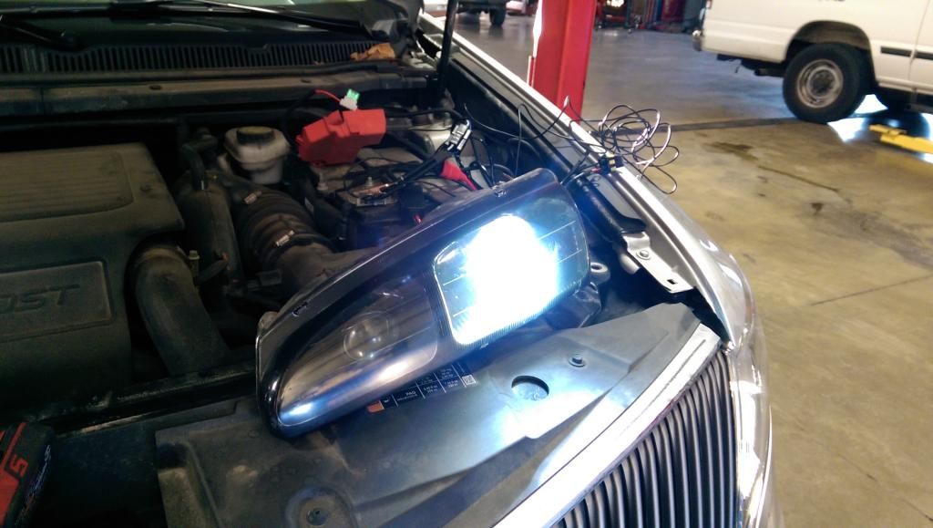

Alright guys, so let me just start by saying that I think we can all agree our headlights are a bit of let down. Projectors greatly improve headlight quality, and beam concentration, plus, lets just be honest, they look 100x's better! No one that I know of makes any projector headlight assemblies for our cars, so I thought I would build my own to my taste. I will walk you through how I built mine, what products I used, and how much it has cost me.
First off, this project is not for anyone that doesn't have patience or any kind of tools. You'll need the following:

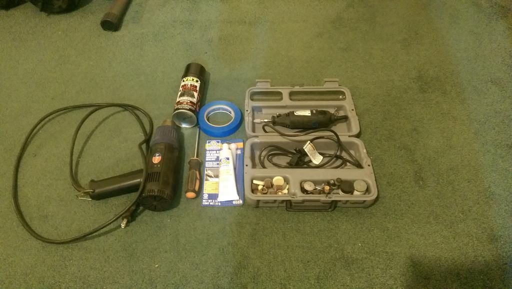

Dremel tool with cut off wheels, sanding wheels, and a drill bit.
heat gun
flat head screwdriver or a wide flat putty knife would be ideal
some high heat paint (if you choose to paint your housing). I chose to use roll bar and chassis paint because it will withstand 250F and its a semi gloss finish
12V battery(used for aiming and testing beam)
Some clear silicone

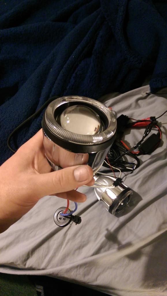

And of course, the projector kit of your choice. I'm using a kit from eBay pictured below
[IMG][/IMG]
[IMG][/IMG]

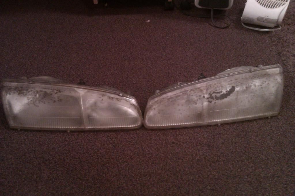

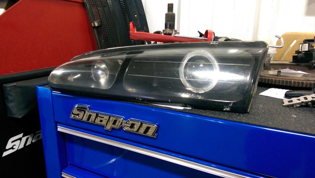

And now You will need to remove your headlights from the vehicle. I don't have the removal procedure, but it's pretty simple, hopefully if you're attempting this retrofit, you have the know how to remove them! Here is what I started with.
[IMG][/IMG]

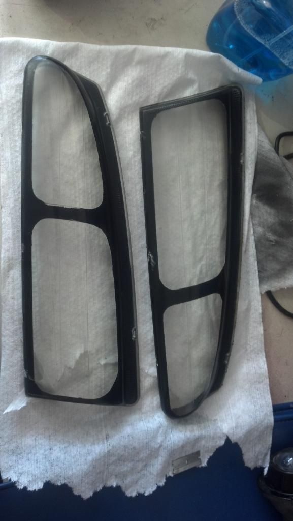

Next you will need to use the heat gun to heat around the edge of the lens to heat the glue so you can pry apart the lens from the housing. I did not take pictures of this process, just make sure you don't keep the heat gun in one place or get the housing too hot because the heat gun WILL melt the housing and or lens. Also do not apply too much pressure when separating the lens from the housing or cracking will occur. If it's not separating rather easily, you don't have it hot enough.

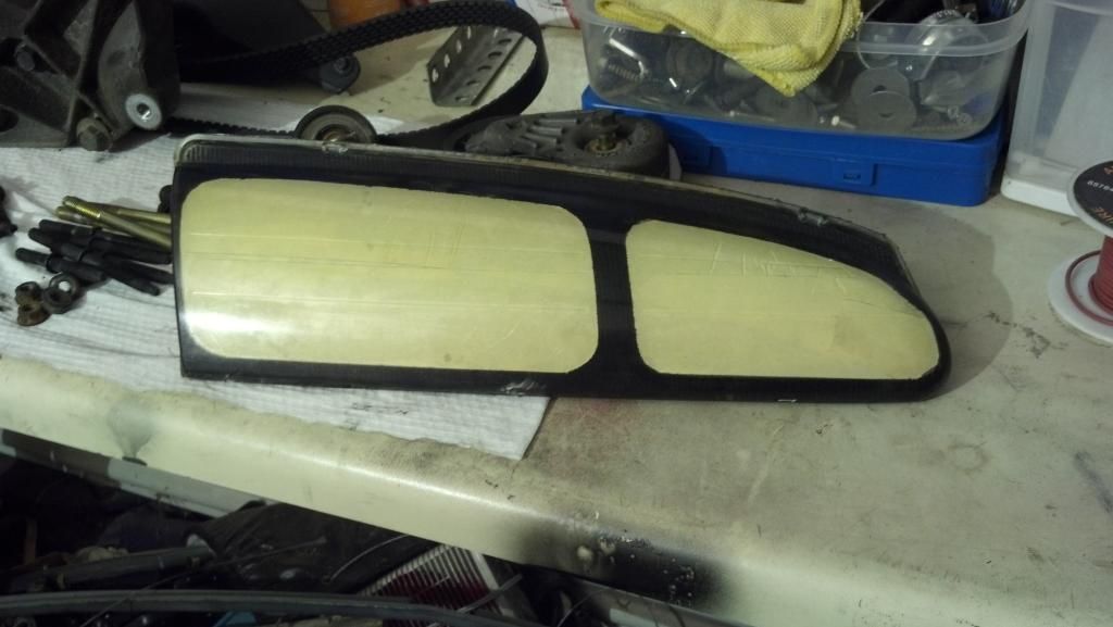

After you have the lens off, you then need to place the headlight on on a level surface, and power the stock halogen bulb up using some wire and the battery. The purpose here is to aim it at an open wall so you can mark where the factory beam aims that way you can aim your new projector to factory specs. I don't have a pic where I marked the stock beam, but here is a pic of the projector aiming where the stock beam is so you can get an idea of what I'm doing here.
[IMG][/IMG]
You can now paint the housings if you choose to. You could even color match to your car if you chose. I just chose a nice semi gloss black, which also matches my car color
After you aim the factory beams and mark them and your housing are painted if you chose to. you're now ready to clearance your housing for the new projector using your dremel. I am also adding a second projector where the parking light is for my track lights. They will glow red. The only picture I have is this one with the housings already painted and a test fit of the new projector after trimming the back out. You can see the old parking light spot is cut out to fit a projector there too.
[IMG][/IMG]

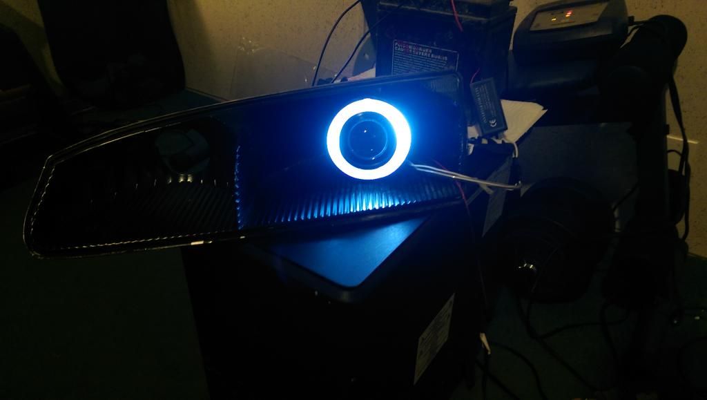

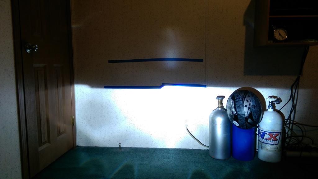

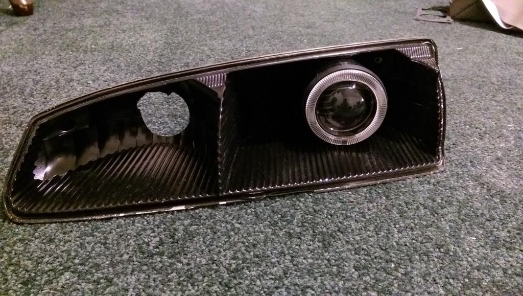

After lots of cutting, trimming, test fitting, and more trimming, you are ready to test out the aim of the projector on your marked wall. Here's how the light should look.
Dims:
[IMG][/IMG]

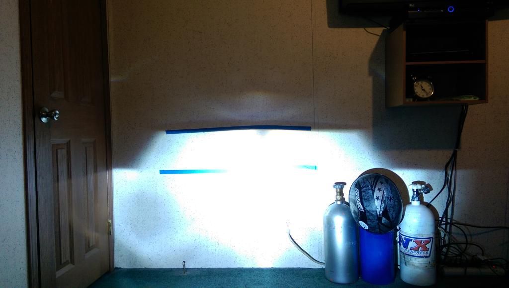

Brights:
[IMG][/IMG]

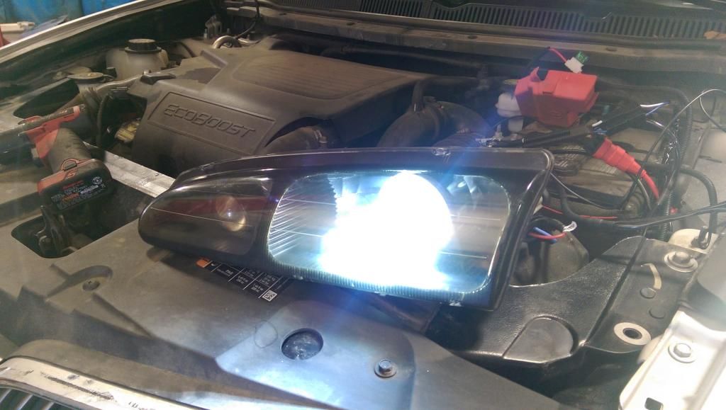

After you get the beam matched up to factory. You're now ready to mount your projectors permantly. The projectors I used had a threaded part on the back and came with a nut to mount them nice and tight. After you tighten the nut, You'll need to use the clear silicone to seal the cut section off so no moisture can enter the assembly, like so:
[IMG][/IMG]

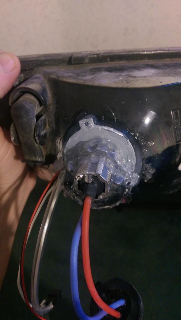

I let mine dry overnight just for good measure. After I applied the silicone, I wanted to paint the edges of my lenses black to give a more custom look. I had seen this done before and liked it, so I copied. Lol. This was the first masking and paint, it wasn't smooth enough around the edges, so I redid it after these pics. And of course, this was after cleaning and buffing the lenses back to clear
[IMG][/IMG]
[IMG][/IMG]

Would you consider making this as two headlight kit (+the extra wiring stuff that we'd need) for a price where you can profit? I'd be willing to pay good money for a set right now.

will look amazing with the finished turn signals...i like that you dont have to cut the bottom of the headlight housing....
How does the bi-xenon work on these specific projectors...is there an actuator that removes the cut off shield?

The cutoff shield is hinged and attached to a solenoid. When you turn the high beams on, the solenoid pulls the shield down which gives you the full beam.

I must have missed where someone asked about them. They will glow red for show and to look mean at the track as this car will see a lot of track time. I've got red LED bulbs on the way for them and they'll be on a separate switch
What about the halos on the projectors, do they stay lit with the projectors or are the halos on a separate switch to operate?

I wired mine up with my parking lights, so they are on with the parking lights, but could be wired up any way you wanted
