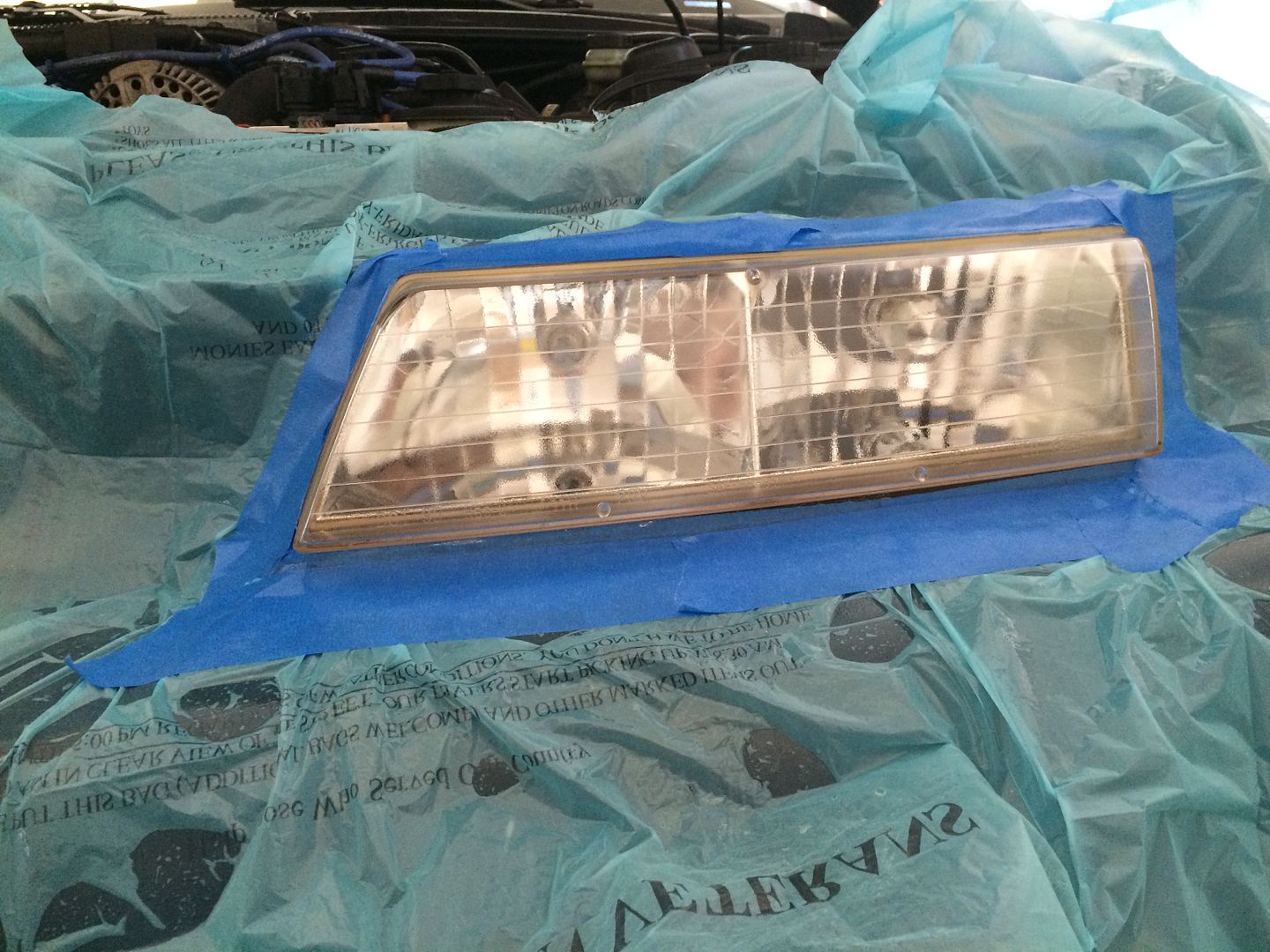

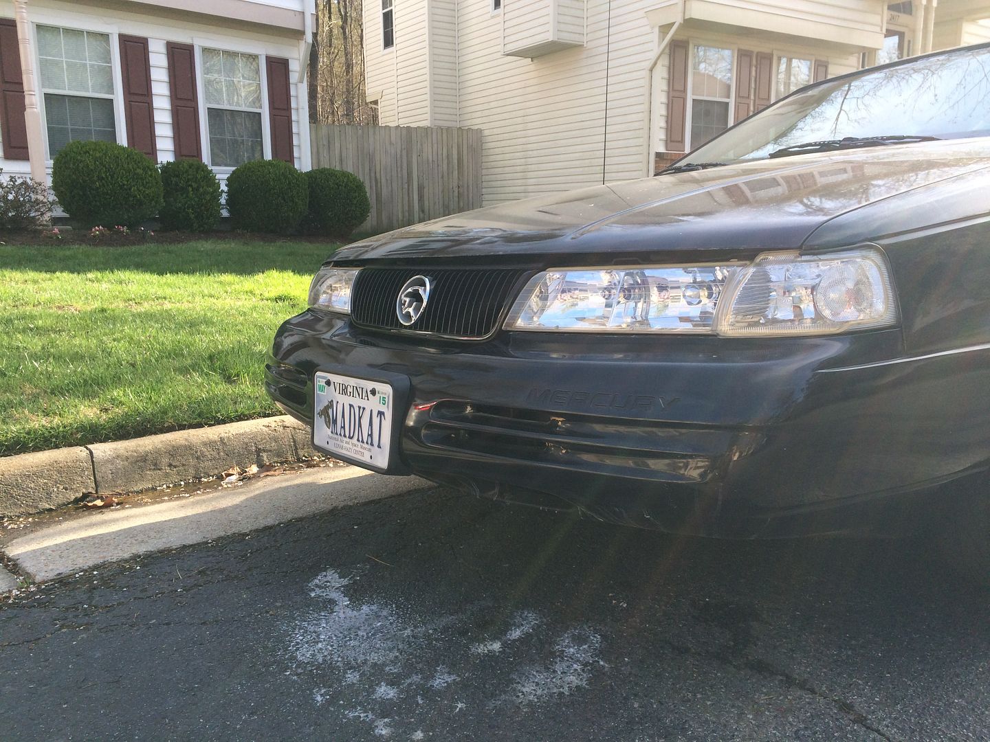

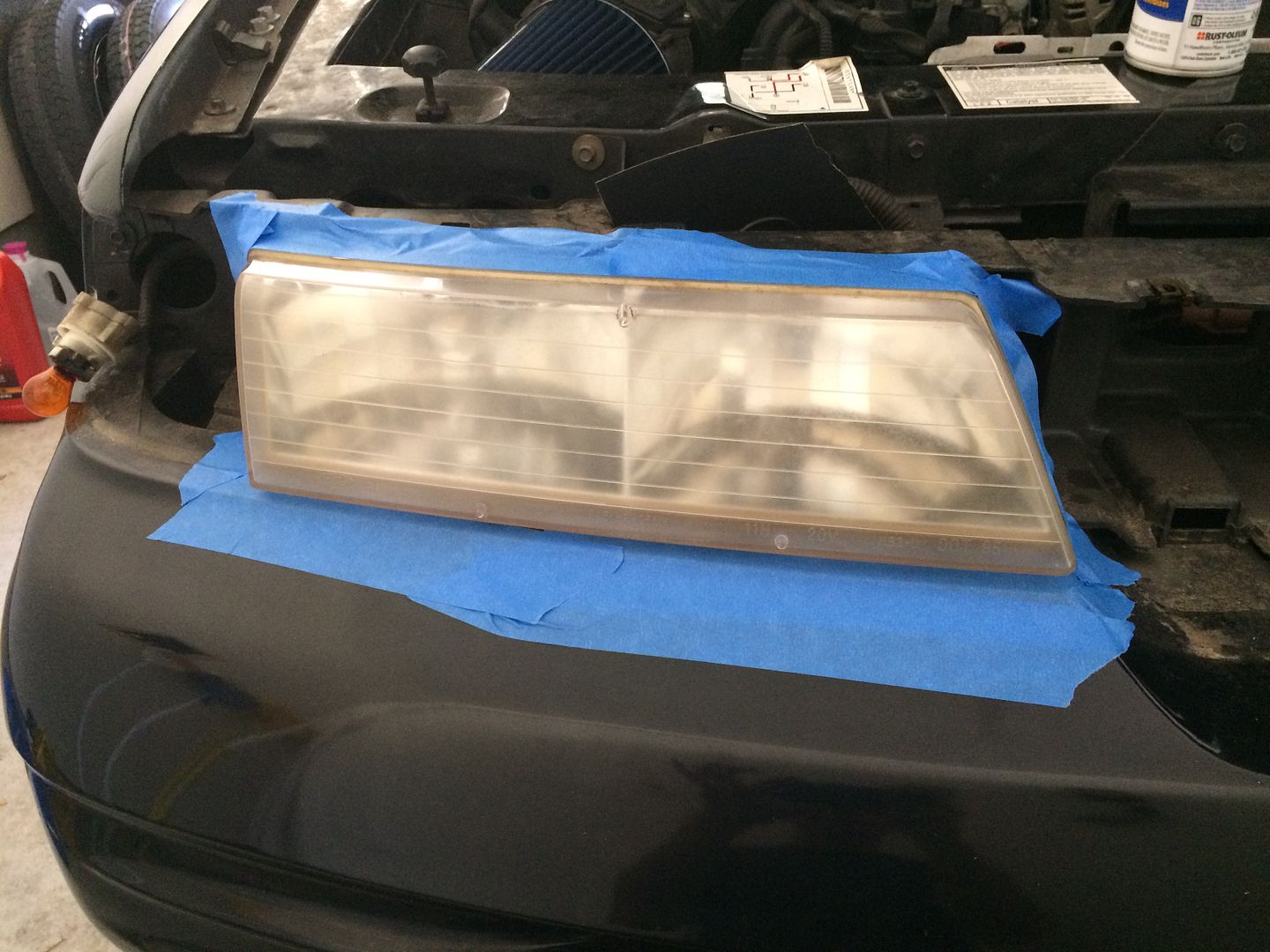

Restored my headlights, they won't yellow again, and no I didn't buy new ones.
BEFORE:
MID PROJECT:
REBORN:

Is that what it needs? Because i noticed after putting the grille back in that everything seems off on alignment, it has been backed into by a minivan while parked before.
Do elaborate.
2011 BMW X5 35i Premium Package
2009 BMW 535i ///M Sport Package
Black_Cat is offline
post #4 of 9 (permalink) Old 04-06-2015, 12:14 AM
Posts: 16,655
There's a like four 8mm bolt for adjustment across the back of the header panel, two to the latch area and two to brackets behind the headlights. Loosen them, pull up on the header panel(helps to have a helper) and tighten whilst continuing pulling up on it. That usually puts everything in place
