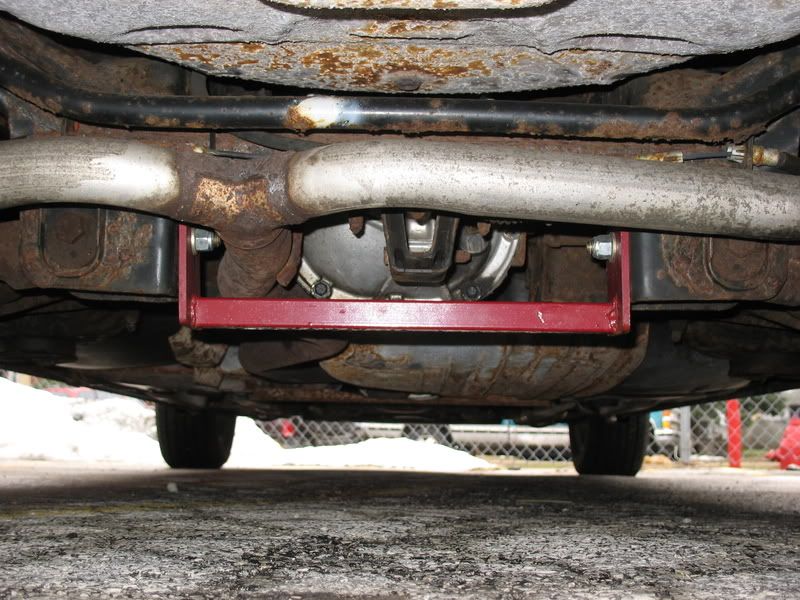

Hello,
This is one of the prototypes, on my 94 LX.
Nick

It looks good but man look at all that damn rust

It does look good. (rust be damned, its not my car! ) I bet it quite effective when combined with the rear shock tower brace.
Question, why the different sizes?

Two of them in the pics are 1/4"x 3"x 4 1/2" the silver one was built for a friend.
His car has a stock 3.8 car (not an S.C.) it uses a 1/4"x 2"x 4 1/2" plate.
The painted brace in the middle of the pics is on my Super Coupe.
I made the mounting holes off set to test another idea.
The early design on Links432's car used a 1"x 1" stainless steel piece.
The new design uses larger/stronger 1" I.D. tubing/pipe.
I paint them all burgundy/maroon now.
The brace does make a difference in the way the cars handle/corner and reduces the stress on the rear axle assembly.
I got a p.m. asking if holes need to be drilled or welding required.
No drilling or welding is needed.
The braces use the two 1/2" holes the rear suspension member already has.
I include the mounting hardware to install them.

The first design of the shock area/trunk braces is about to change.
I am now looking to mount the brace level with the top of the shock mounting area.
I will compare using 1/4" flat stock versus 1/4" angle stock.
I will test using both 1" I.D. and 3/4" I.D. tubing/pipe as well.
I will stay with using two 3/8" bolts per side to secure it in place.
It will no longer be able to be hidden under the trunk mat.
These braces will include 3/8" bolts, washers and nuts to mount it.
I currently have three rear braces assembled and will build more soon.
So far everyone is happy with them and have encountered no installation problems.
My design is simple and effective..........period.
I can custom make one to fit the depth of your exhaust system at NO extra charge.
They do not interfere with the lower arm movement and do not require holding multiple pieces in place to secure them.
Wheel hop............I may try to make changes to the rear brace and see if we can address this.
This will involve additional pieces and more welding and testing.
Everyone seems to be building some type of brace now.
I have an idea to expand the use of my rear braces to strengthen the axle and rear sub frame.
My first few rear shock/trunk braces are built from stainless steel.
If I continue to build them, I will use 1" I.D. tubing/pipe for them.
I will use ONLY grade eight bolts to fasten them.
I am using pieces that allow the maximum surface area to mount them as well.
The difficulty is getting a standard drill motor and bit in that tight space.
I may include a template to drill the holes from the wheel well.
(wonder if anyone else will "use" that idea?)

I like this but looking at nicks picture wouldt it the better if that brace wast so low if it was tucked in maybe better support ? or was that just a prototype ?

Hello,
Mine was just a prototype, I was just given one of the final design braces but since it is cold and snowing, I have not put it on yet to take pictures.
Nick

I got one of these braces and it was so easy to install it only took about 5 minutes to bolt it in. All I can say is NICE. Thanks Ron

The cold and snow/salt/ice have delayed serious testing of the trunk/shock braces under the conditions I want.
The idea of reducing wheel hop using the rear brace is on hold until better weather as well.
Have five rear braces currently ready and set up for building more.
The rear shock/trunk braces will be ready shortly..........I hope.
Working out some other ideas with them as well as the easiest way to mount/drill holes for them.
I may bore two holes in my car and weld the brace in place just to see how that works.
The rear brace/pinion support and possibly rear sub frame connection is still in the design/trial stages.
I'll be sure to pass one along to Mark (SCBird) for his Super Coupe too. I built a brace for his 3.8 standard car too.

I'll be making four final test shock/trunk braces for testing.
The production pieces will more than likely have either 3/4" or 1" I.D. tubing/pipe.
The side pieces will be from 3" x 3" x 8" x 1/4" mild steel.
They will have four grade eight bolts PER SIDE to mount them.
I'll either paint them gloss black or gray primer and use trunk spackle paint on them.
They may match the trunk mat better, but will require cutting a hole for them to pass through the mat.
I may offer them as a package deal with the rear braces at a much better price due to the poor economy.
