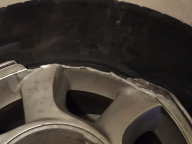

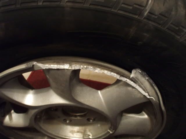

got some pics of my EX front fanblade here.. (brings a certain monty python quote to mind lol)
Photobucket
Photobucket
lower control arm hit here..
Photobucket

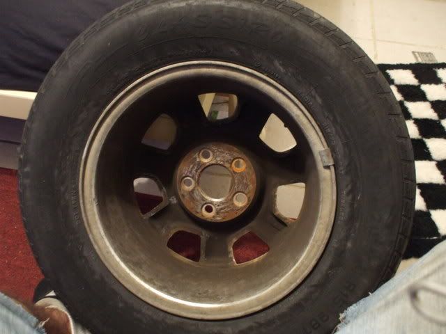

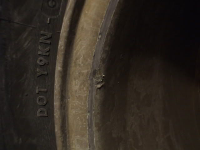

and this is a nice lil rash (thin line around the edge of the rim..) from having to move the car into the parking lot of the gas-station.
Photobucket

Wow. Never seen that happen to a tire. Glad you weren't hurt, and it sounds like no one else was either.

i was doing about 15-20 when i hit the curb.. and actually i was in the outside of the 2 turn lanes and when i over steered the ass end of the bird came about a foot from the car that was in the inside lane.. at least thats what he told me anyways..

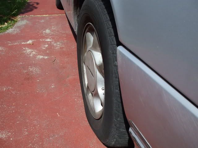

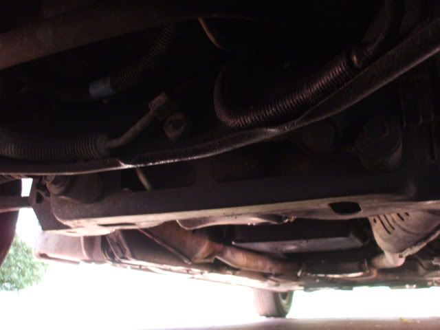

well i got some more pics of the bird... is it just the way im seeing it or did i buckle the K member?
Photobucket

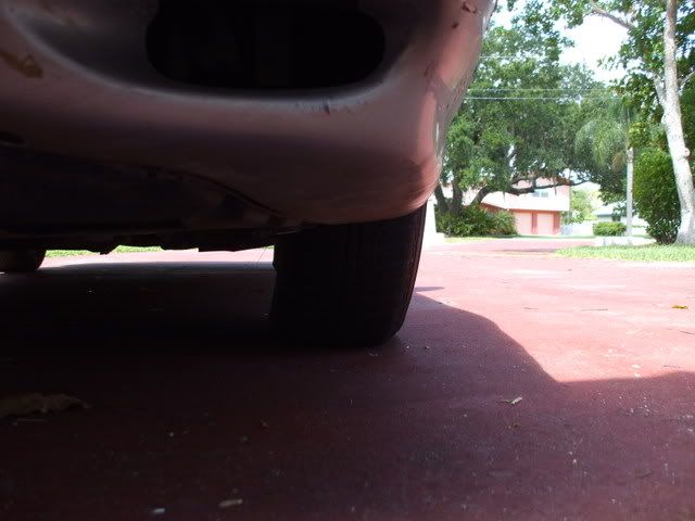

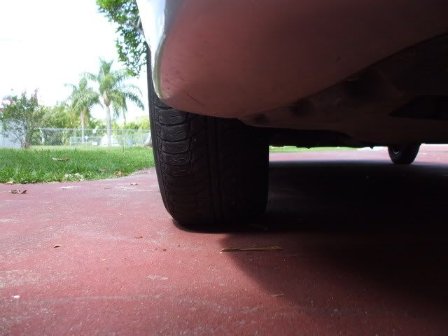

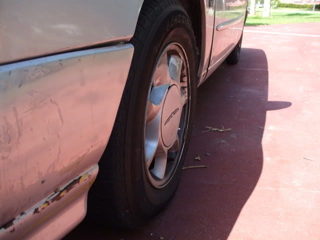

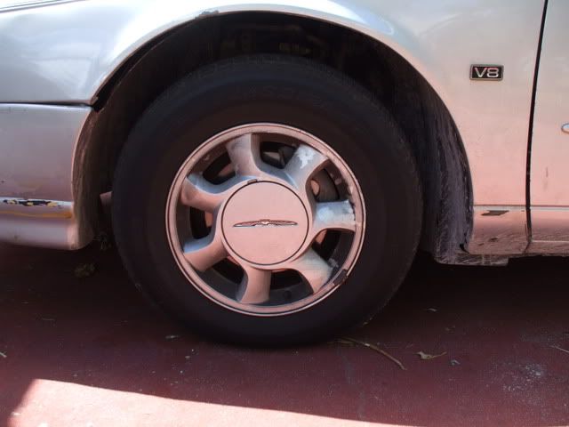

heres how the front tires are sitting..
Photobucket
Photobucket
Photobucket
Photobucket
Photobucket

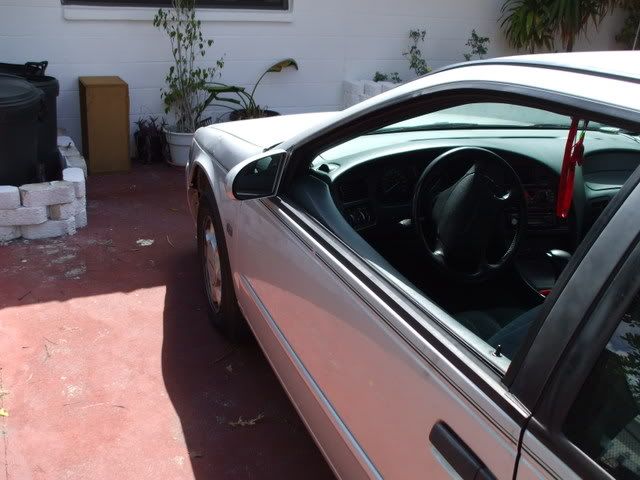

and heres my steering problem .. notice the difference i the position of the steering-wheel and the front tires..
Photobucket

There should only be one "dip" in the K member, in the middle, for a place for oil to drain out of.

You definitely damaged the subframe/k-member there. The damage extends way beyond just the rack and pinion. You may have even bent the spindle, strut rod, and/or lower control arm, but you wouldn't know for sure until a good alignment shop sees it. So you are looking at the following list of items to replace:
  • Subframe/k-member
  • rack and pinion including right outer tie-rod
  • rim
  • spindle (very likely)
  • LCA (possibly)
  • strut rod (possibly)
IMHO there is a LOT of work to be done to get that thing sellable to another person. If you are honest about the damages, no one will want to buy it except for a junkyard. It sucks, but that's the grim reality of it.

well i got under her and started taking things apart.. my LCA is fine.. my suspension aspect is fine.. (apart from deteriorating bust boots and bushings.. lol) but my innser tie rod is "L" shaped.. ill get a pic once i get it off the car.. which poses another problem.. on the fluid boot that covers the inner tierod/rack and pinion connection.. how the hell do i get the pinch clamp off the fluid boot.?
