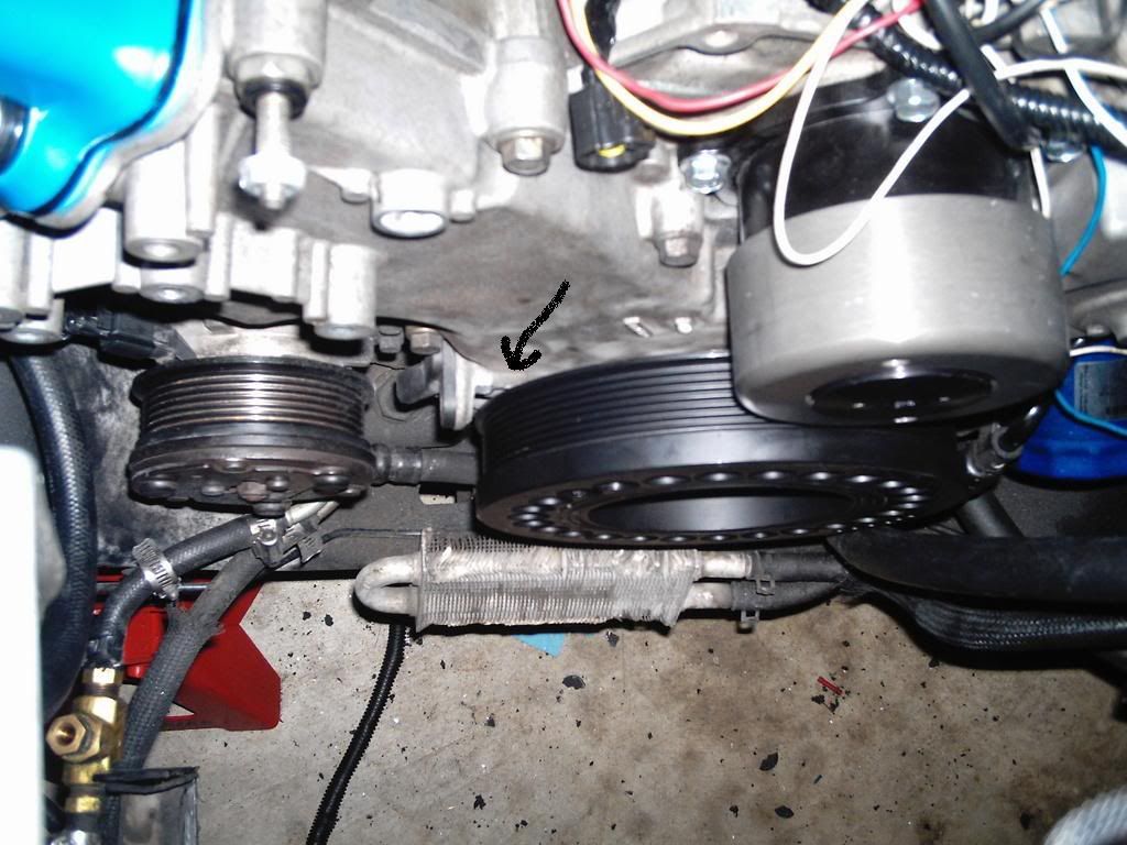

Where exactly do you need to grind on the timing cover...I apparently am having clearance issues

On the crank positioning sensor journal. You might not need to shave this much though... this is my 8.5'' dampener. Also had to grind down the backside. Be very careful not to break a hole on the cover.

I dont seem to have an issue with the CPS....You also had to grind down on the timing cover as well?

Originally Posted by Slowpoke View Post
Hey thanks.
This is just a disaster!
No prob.
Well I considered my CPS journal as part of the timing cover.... so other than the that, i did not have to grind anything else down. Just what you see and on the back that is not visible in this pic.. part of the journal I guess but the backside, because the dampener also rubbed on the back.

Thanks man..Seems my balancer is also a tad different then yours. WOnder if there can be differences in timing covers as well...Ahh Guess Im pullin it off!

mmmm... how big is your dampener? 7.0 or 7.5''? From what I understand up to a 7.5'' doesnt require shaving down the journal.
I have seen the Innovators, they are different but as far as clearance issues it should be the same. Timing covers might be different, im sure our pulleys are a little different, but the only other place you might have clearnace problems I could imagine would be the water pump. But again, I think up to a 7.5'' it should clear. I HAD to change to a electric water pump with a smaller than normal pulley on it, but thats only because my dampaner is massive.

I have an electric waterpump and no tensioners on yet..I wonder if I could have possably overtightened the balancer. I imagine it only goes on so far but who knows at this point.
There does appear to be a raised aluminum bump its interfering with..Wonder if thats it. I;d juts like to hear someoen say.Oh yah..I had to do that too!
the balancer itself looks as though its on at the right depth
Yeah that is what I meant about grinding the back side. The CPS journal has a little hump that extends a little further towards the center of the cover. Here you can see it on this pic. I don't think you can crank down the dampener to far... when it bottoms out, its set. But if your new dampener extends far enough to hit that extra little humpo, it will seat on it and rub. I had to grind that one down also... still had more grinding to do on this pic... I don't even think I had started on the back hump yet.
You can see here that the stock dampener does not reach that extra back hump...

I think I have a pic of the finished grinded journal and cover without the dampener at home. Ill search for it tonight when I get home from work... it will help you know how far down to grind.
But what I did is I put on the stocker all the way down, and then measured the distance from the back of the dampener to the timing cover, then eye ball across to the hump, and you can see where it would hit if you could magically just move the dampener over to the left. Be patient on the grinding... I don't know how thick that hump is... but you do have more material than you would think.

Here here go....

Thanks man. I think my cover is slightly different but thats about teh spot. I will recheck tomorrow. Your dampner is definitely larger then mine..I got the 10% OD..
