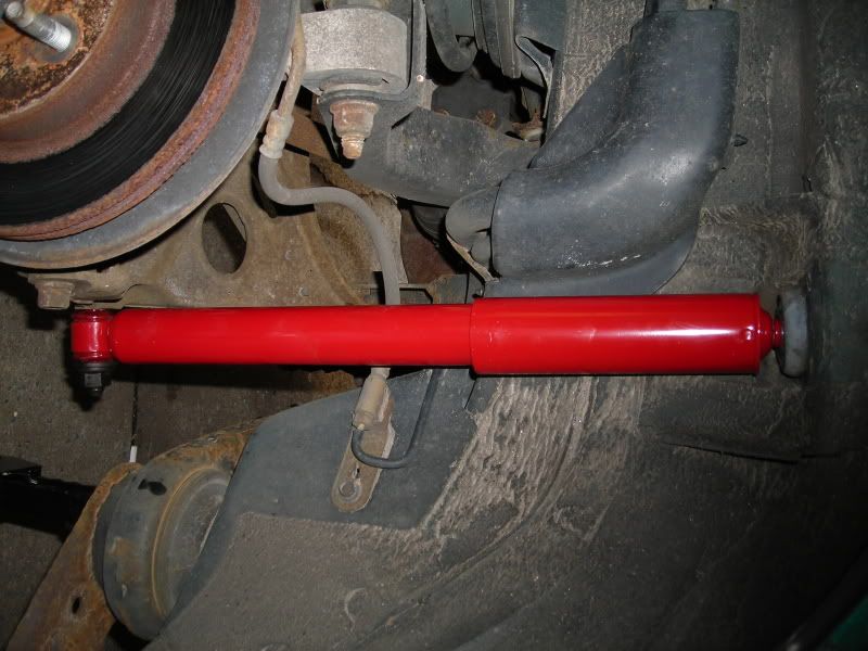

Oh believe me if I were using a scissor jack this wouldn't of been contemplated lol. I got a new jack and jack stands from craftsmen for christmas they are 3 ton capacity and work very nicely. I also found once I took the old shocks out they no longer decompressed on their own, they would stay collapsed unless you pulled them out... Also in the passenger side rear shock the lower mount the rubber bushing was warped and the metal spacer? was really messed up and in bad shape and it was able to fall out of the lower shock bushing on it own once the bolt was removed. I have pictures of everything that I will post up soon While I was at it I replaced the dist cap and rotor and decided its time for new plugs and wires.
p.s. with the rear shocks replaced the rattle my car had is slightly less then it was before. Front struts are next but I dont have a spring compressor so I am not going to be doing that myself. Anybody want to help? lol

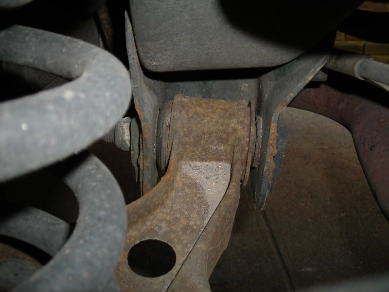

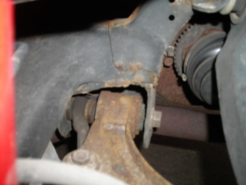

Here are the pics, I am concerned about a few things but I don't know how worried I should be maybe you guys could tell me.
First concern:
Second, don't know if these look that bad but they don't look great either
Third:
And last but not least:
The other side looks pretty much the same so what do you guys think?
And here are the new shocks installed:
The old shocks no longer would decompress on their own.

id change the control arm bushings and the endlinks, oh and your brakes!

I'd do the bushings and toe links, and while you have it all off, clean all the rusted metal, etch it, and put some heavy epoxy based paint on it; something rust resistant, for sure.

How hard is it to do the bushings, am I better off bringing it somewhere? DO you guys think it can wait? because the front end is in more need of work then the back end right now so that was next on my list.

The bushings are a pain because the LCA has to come completely off the car. I wouldn't be too worried about it though. The LCA isn't going anywhere, so you might get some noises, and maybe if they are really bad your rear tires might wear a little unevenly, but it isn't a safety concern. Take care of what the front needs first, and then when you get the time/money, go through everything on the rear at one time.
