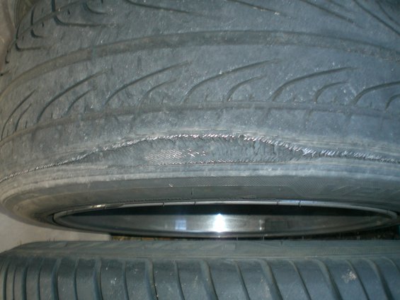

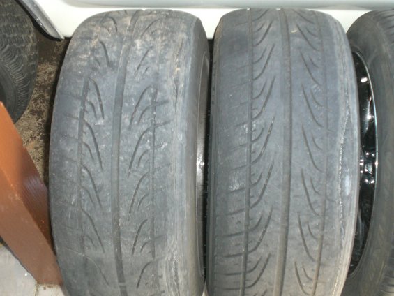

Bangster is offline
post #18 of 22 (permalink) Old 02-01-2010, 06:16 PM
Posts: 7,781
Ouch !!! close to a blow out
post #19 of 22 (permalink) Old 02-02-2010, 07:54 PM
Posts: 10,172
That pic also shows that the alignment is the problem, lol.
Toe-in will cause both the vibration and the wear pattern.
Been there, done that. Tie rod end replacement, AFAICR.
Did you change the alignment after changing wheels?
Grog6 is online now

That picture is not from the OP. I don't think the OP has found a solution yet.
A loose tie rod can cause a vibration. Is that the inside edge of the tire burned off? I can't tell from the picture. If its the inside, the car was toed out (negative) or a severely loose tie rod allowed it to toe out a ton. Those tires (in the picture) look like they are just completely worn out and the inner liner poked through because tires naturally wear a tad more on the outside edges if left on the front end for awhile (turning). Bangster's front end was probably not even that toed out of spec if it even was.

I would say that's the inside cause they're directional tires.
