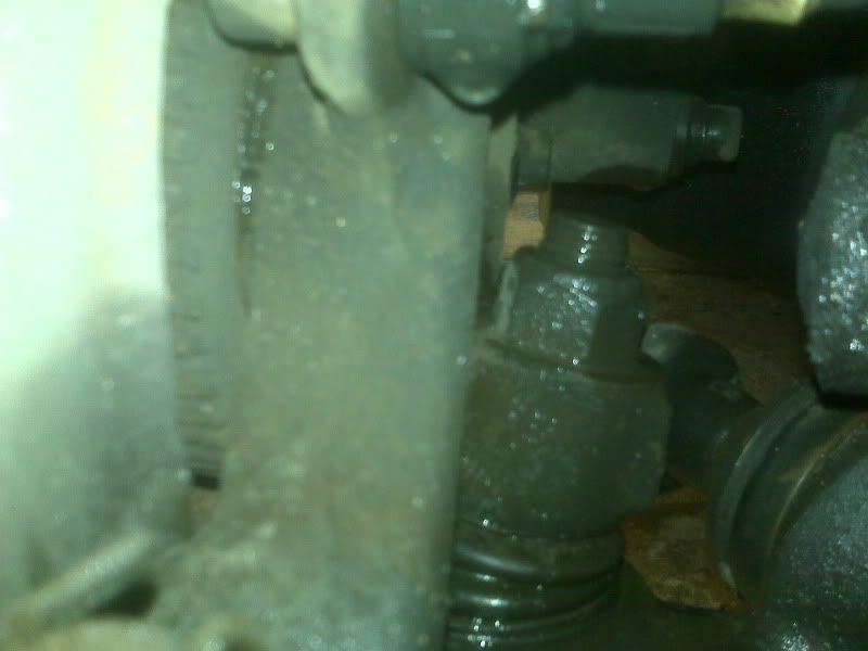

Everything looks wet because it was raining out but the only things I saw that were not in "great" shape were the strut rod bushings at the K member and the strut mounts up top.

The parts you took pictures of look ok ... but you said there is some play at the strut rod bushings @ LCA and the subframe ?? Got any pics ? I would replace those if they feel loose at all.

I don't have any brake pull at all. As far as the strut rod bushings the ones at the LCA have just been replaced last month. The ones at the sub frame are a little worn and have some minor cracking in them but aren't at all loose or terrible but could use replacing. When I did the upper arms I tightened them to spec once I put the weight of the car on them as to be sure they wouldn't bind .
When I push down right on top of the wheel well on the fender I get the noise, it isn't as loud but I am able to hear it. I think it may be the strut or strut mount but I will do even further inspection when the rain and Gail force winds stop. It is hard to see in the picture of the strut mount but it does have a bunch of tears in it most of the way around.
