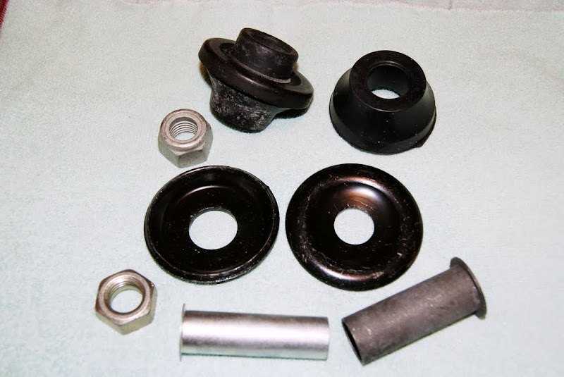

Well, I FINALLY replaced this past weekend the cheap NAPA bushings/parts I installed on my front suspension strut-rods last year with brand-new Ford parts! However, like all work I attempt on my 1997 Thunderbird LX sport, this repair was not without great difficulty. It started right off the bat when I picked-up the second kit from the Ford dealer - take a look at these photos:
This is the first kit I ordered from a dealer in Omaha, NB

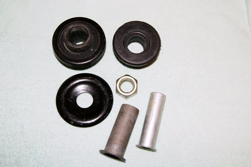

This is the second kit that I got from Mike Bass Ford in Sheffield, OH (fairly close to where I live)
Notice anything different between the two kits?!! That's right - the 2nd kit was missing two pieces (a washer and a nut), which I didn't discover until about 1:00 a.m. Saturday morning! I was supposed to go to my dad's house at 8:30 that morning to work on my car (I live in an apartment and have no place there to work on my car)!

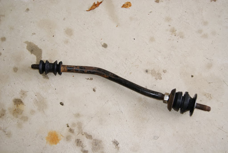

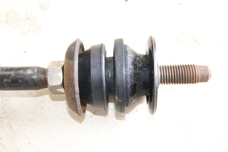

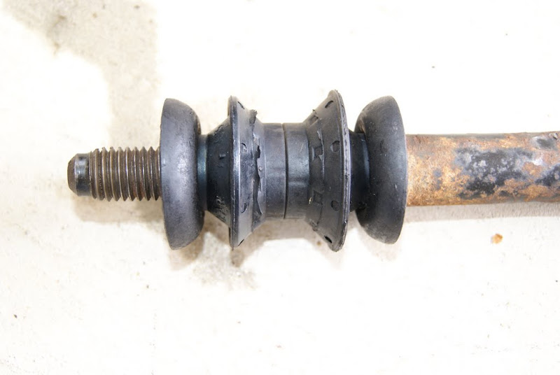

Here are some pics that show how to assemble the Ford parts on each end of the strut-rods:
The nut on the right end of the strut-rod is missing in this photo.
The nut on the left end of the strut-rod is also missing in this photo.
