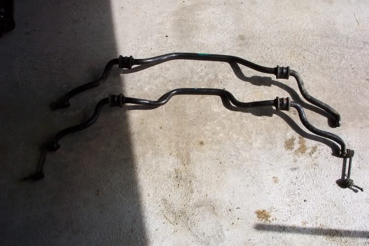

I noticed a significant difference when I swapped my SC bars in. The big difference I seen (and I'm sure you will on the 94), is the shape of the front bar (LX vs. SC). The SC bar has a lot less bends in it, in addition to being fatter. Mine are from an 89 BTW.

Pic I have from when I swapped them....SC bar is on top...
~Jeff
