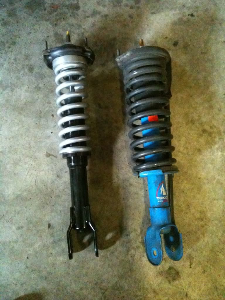

Had a few races to try my custom Koni coilover setup. They work great. 650 lb rate springs are amazing on these cars. It's astounding how fast it changes directions now. Where before there was plenty of front end dive and roll, it's now way flat
The only problem being now, it seems that Koni has discontinued the 8649-1201, the front strut for our cars. After I got them installed the first time, after driving around the block, one of the struts had blown out all it's oil. I will say they that Koni was able to get mine repaired in time for the first race

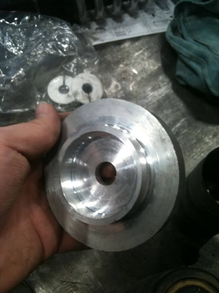

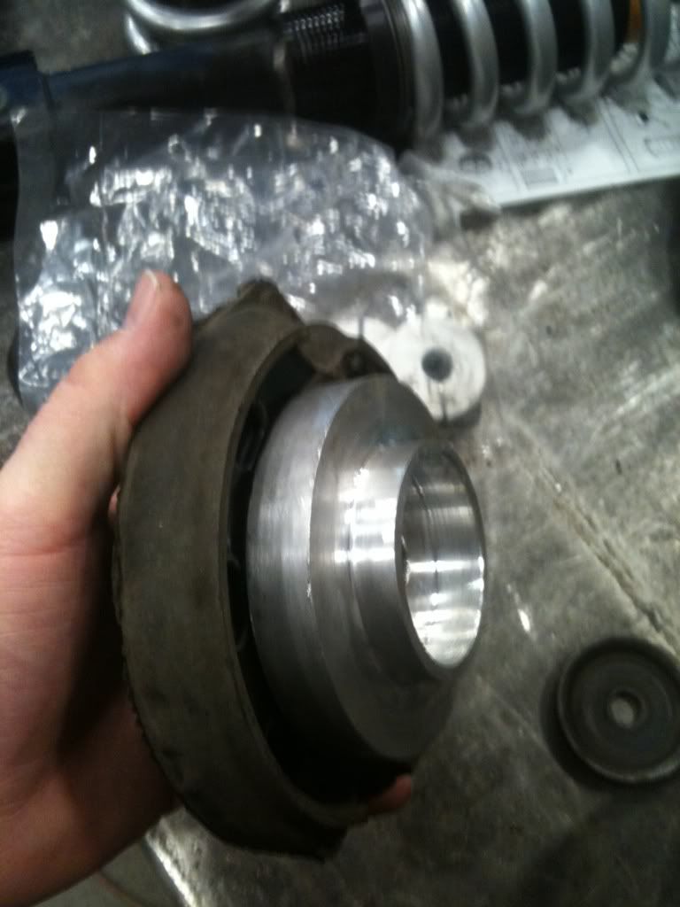

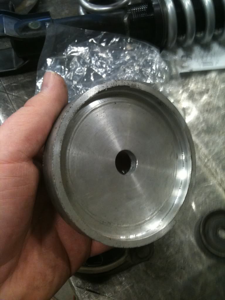

The main reason I did it was so I had more options for spring rate. These are over 200 lbs stiffer than the Eibachs they replaced. The ride height is adjustable as well, which would probably be more of a benefit for a road race car, or maybe a more street driven car with track duty. As my car is more or less committed to auto duty, I've just set my ride height here I want it (And where it's high enough for my door to clear the tire on my trailer lol)
There's a special bearing that can be installed between the bottom perch and the spring, that makes it way easier to adjust the spring. Another nice thing about these is they don't require a spring compressor to disassemble. So it would be possible to change the spring rate trackside. The ride height could easily be adjusted during a pit stop. There's a spanner wrench that fits into a notch on the lower spring perch, and easily adjusted. The struts are easier to adjust, just a little dial on the top of the shock.
I also took some pictures of the top seat. I got it lathed out so it would fit on a stock upper rubber perch

If I understand correctly, you need that custom machined top spacer b/c the overall length of the spring is shorter than what's required in the tbird application, right?

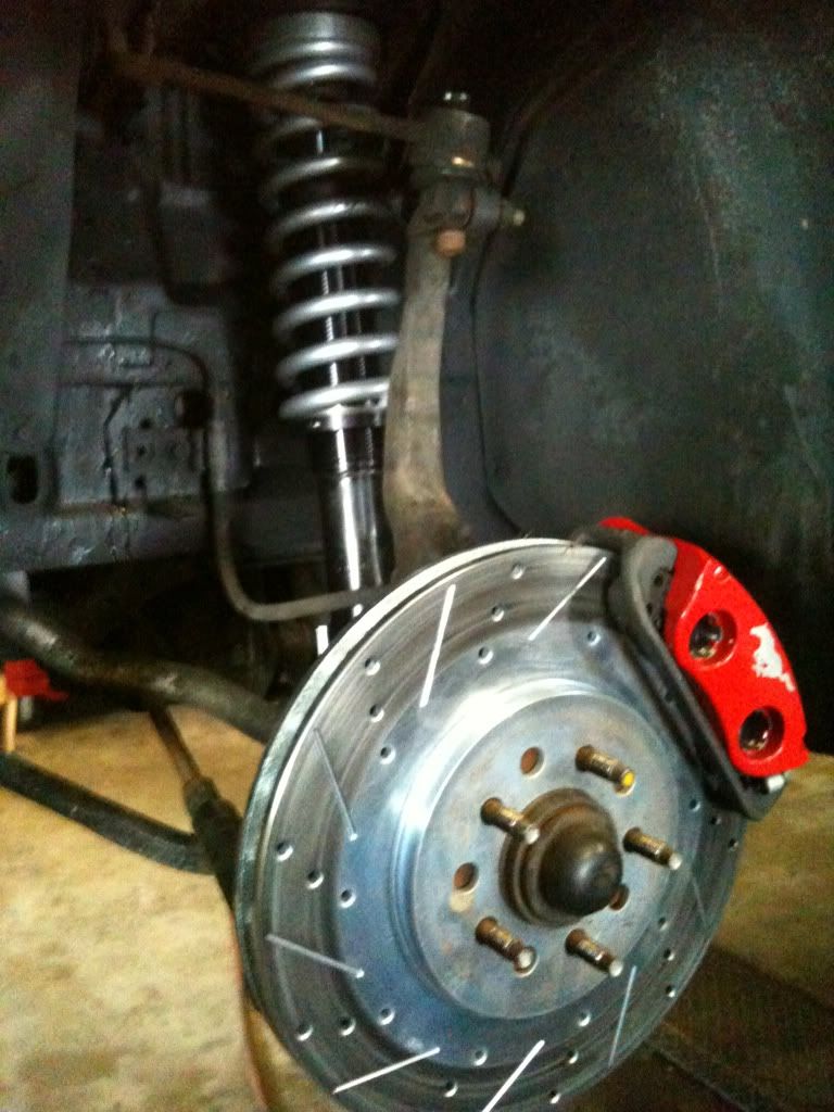

Does the coilover setup provide room for wider tires/rims? I look like it might since it looks like the overall package has a lot smaller diameter.

No, coilovers wouldn't provide any more clearance because there is still a spindle in the way.
That's right, it is the spindle where it attaches to the upper a arm, not the flange on the bottom of the shock that is in the way.

Negative, The top 'spacer' is more of an adapter to use the replacement coil over spring with a factory rubber mount. I figure that way should be better for component life, and less transmission of road noise. If the spring was shorter, the bottom sleeve could be adjusted up as necessary.
In the rear I'm still using to stock setup, with Tokico blue shocks and Eibach springs. The Eibachs are almost as stiff as they come, and I didn't want to buy new springs for an extra 20-30 lb rate. I also contacted Eaton springs, and was quoted $3500 (!) for custom rear springs. I can't go to coil overs on the rear secondary to the class rules for SP cars in Solo 2. I can change the spring and shock, but can't change the mounting points.
