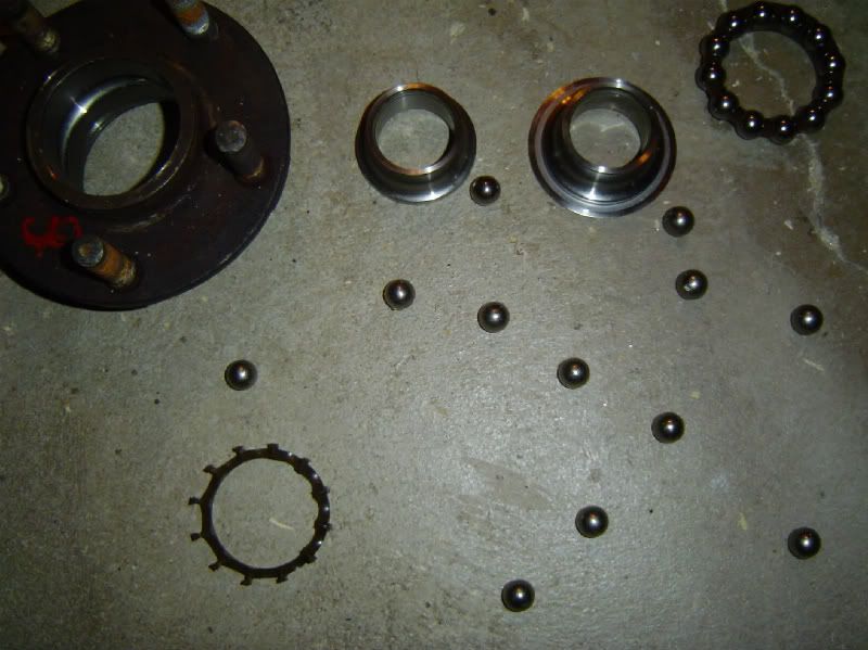

HMMM: The bearings I took apart (Read as: blew apart with the rear knuckle and a press at 20kpsi) were tapered rollers...
They had had grease on them at one time; the crusty marks were still there.

ah, their ball bearings too eh? neat. i might have to just go ahead and tackle that job one of these days, see what happens.
they arnt supposed to come apart like that are they XD wonder if those ball bearings would work in the window motor instead of those plastic dowels
