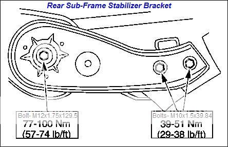

Rear Sub-Frame Stabilizer Bracket Bolts
It looks like all the bolts that hold the rear sub-frame stabilizer brackets have been discontinued by Ford..
I'm going to post a diagram for anyone who needs this information in the future:
The size of the large bolt is: M12x1.75x129.5
The size of the 2 smaller bolts is: M10x1.5x39.84
The torque specs are listed as well..
