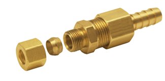

Something like this should work and should be available from Lowes/Home Depot/Ace hardware, right?
According to one of the DIYs, I need to just cut the hard lines and use a 5/16" compression fitting to 3/8" NPT barb, right?
Q: That would be this, right?

Q: Or, am I better off just cutting the end off the A/C lines and finding some appropriate compression fitting (just as suggested for the to/from ATF hoses?
Example, I could go from 1/2" compression to 3/8" NPT...
1/2 Compression to 1/2" Male Pipe Thread
http://www.hardwareandtools.com/Ande...r-u122928.html
1/2 Female Pipe Thread to 3/8" Barb
http://www.rebelbrewer.com/shoppingc...Stainless.html
Am I on the right track here?

A quick trip to a hardware store yielded the following bits/options:
* Cut off A/C hoses to make female Springlock -> 1/2" metal pipe adapters
Buy (2) 1/2" Compression Nut (to 1/2" FPT) $3.98
Buy (2) 3/8" Barb to 1/2" MPT $11.18
Total for A/C condensor => new hose adapters $15.16
Buy 3/8" high temp hose x 5ft (however much I need) TBD
Cut existing ATF cooling lines to make engine -> 5/16" metal pipe
Buy (2) 5/16" compression Nuts (to 5/16" FPT) $3.58
Buy (2) 5/16" Flare (male) to 1/4" FPT $3.98
Buy (2) 3/8" Barb to 1/4" MPT adapter $6.58
Total cost for Engine => new hose adapters $14.14
Possible Option:
Buy (1) 5/16"" pipe joiner. Essentially 2 comp nuts plus a male-male adapter.
Separate into:
- 5/16" compression nut to 1/4" MPT (confirm threading on the male-male adapter)
- 5/16"" compression nut to 1/4"" FPT (confirm threading on the male-male adapter)
$3.99 for set
Buy (1) 3/8" Barb to 1/4" MPT adapter $3.29
Buy (1) 3/8" Barb to 1/4" FPT adapter $3.29
Total for this Option $10.57
Scenario 1 Total $29.30
Scenario 2 Total $25.73
If I can buy the springlock -> barb adapter for less than $10, it'll be worth it (esp if one of you guys will buy my AC bits come summer).

don't use compression nuts on the atf lines, jut go buy 2 of the longest lengths you can find and they will come with nuts on the ends.

Maybe I misunderood what you are wanting. I have to say I would fab something up. I am certain I could take a small piece of copper tubing swage the end to fit then braze it on and put a bubble flare on it to hook the lines to.

One one end, I'll need a female spring lock to attach to the male springlock fitting on the A/C condensor.
On the other end, I need to hook it up to the existing lines. The DIY says to cut it back a bit but if I understand you correctly, you are proposing to redirect the lines around from the right side of the radiator over to the top left (where the condensor connectors sit), right?
1) I'm not sure which end you mean to "swage to fit". Are you saying to make your own female spring lock by with a swage tool to force the metal open?
On the other side, you mention running using a bubble flare. I'm trying to understand where you think I should run this line since the existing ATF lines already have some kind of nipple with a nut that goes over it. Do you mean to suggest I abandon the factory hard lines altogether and attach my newly created lines straight into the engine?
Q: Did I understand your advice correctly?
One thought:
If your concern is that compression fittings will NOT effectively hold the pressure of the ATF fluid (and will give out before the hose being pushed over 3/8" barb and hoseclamped), one solution would be to attach the stub of the metal pipes and silver braze the connector onto the pipe.
If your concern is that BOTH the compression fittings AND the rubber hose over the pipes will give out, well, I guess I could silver measure, bend, and silver solder the appropriate connections onto it.
Thanks again for your advice.

Compression fitings are just expensive. They are also prone to leakage I avoid them whenever possible. I was sugesting to make your own adapter and braze or silversolder it on that way you do notneed the spring clip. I undertand the budget on this car (not for the sake of being cheap but for the rules) and every penny counts.

Any comments on Brass vs. zinc plated vs. SS fittings?
Brass fittings seem to be rated to 1K PSI and 250F,
Zinc plated steel is good for 6K PSI and 500F,
and it goes up from there. Price also goes up accordingly from what I can see from grainger.com
Since the max rating likely has margin in it, would running brass be an ok idea, a mediocre idea, or a really really bad one?

For atf any of it will work, brass is easy to weld or braze.
