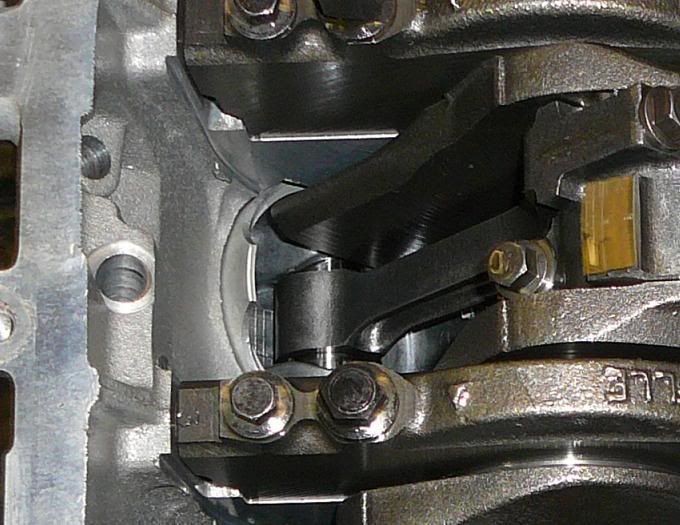

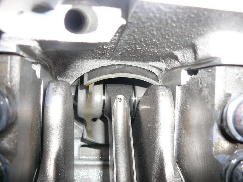

So whats the NEW verdict on the whole rod angle talked about before?
I was going to build a 324 but ended up going 304. When I did my build there was a lot of talk about the rod angle on the stroker. Well, some time has passed, and there is a lot of strokers out there that seem to be holding up very well.
So now leaping two years forward from when I did my build.... I'm about to endeavor a new level of power which will require Billet rods. I'm back to wanting a 324 again.
BIGPETE... You said that the 324 is pretty useless on a SOHC... BUT with power added its another story.... right?
In MY opinion: The rod angle worries that some have expressed about the stroker setups are unwarranted. I'm running this rotating assembly:
http://www.livernoismotorsports.com/...t.phtml?p=1553
I had everything balanced and coated. It is surprisingly quiet on cold startup for a forged engine, especially when you consider the rod angle. I built the engine around a 7K rpm limit, and that rotating assembly has no trouble handling that. I certainly don't mind the extra torque, either (which was clearly evident on the dyno).
To be perfectly clear, I'm not claiming that a stroker setup will outperform a big bore. In my case, my block only had 3,401 miles on it, and needed no more than a honing of the cylinders. However, the stock rotating assembly was trashed. Since the stroker rotating assembly was only $100 more than the stock stroke assembly, it just made since to take the step up in displacement. Also, with 4V heads and a twin-screw SC, cylinder filling isn't nearly as much of an issue as it would be on a NA 2V.
Before the subject of "strokers pulling the pistons out of the bottom of the cylinders at BDC" comes up, here is a picture of the stock rotating assembly at BDC:
And here is the stroker rotating assembly at BDC:
Hope all of that helps.
-Rod
