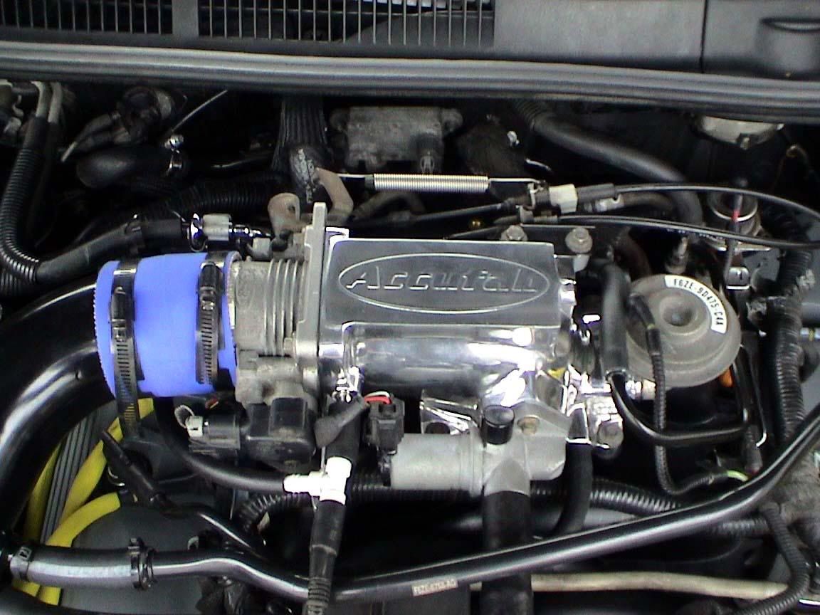

Can anyone repost the picture that jordansypek posted? I really want to know how to do that T adapter but the link no longer works.

you see the brass thing? that's the T. the hose is 3/8 tranny hose that starts from right side next to the egr valve. the hose is just a bit lover a feet long. buy that 3/8 tranny hose and bring to home depot or lowes and get a brass T. i think the T i use is 1/2" because 3/8" is a little bit small.

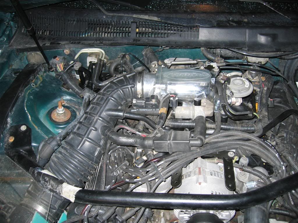

my contribution...bad pic but i did what casper did but with a plastic fitting
