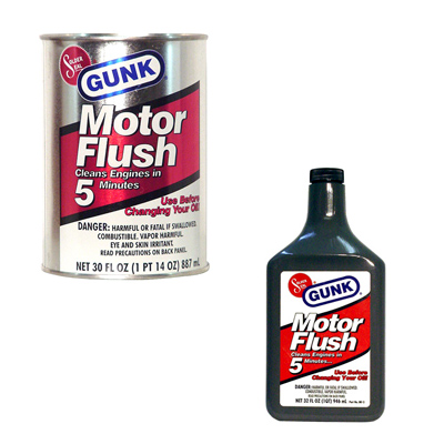

I imagine this is what you're talking about?

May be the same stuff, but it's actually:
http://www.autozone.com/autozone/acc...er=523555_0_0_
Again, that may be a AutoZone-specific package. Nobody else in town stocks it, however.
Which reminds me ... *makes note to buy two more for the next two oil changes in the Dakota*
